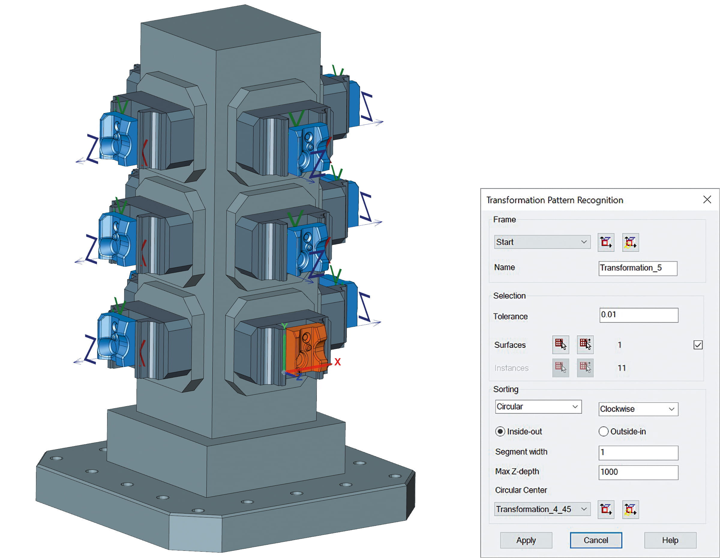

“General transformation pattern” feature
This feature uses a selected reference geometry and searches for the same reference in all other models. From this, it creates a general transformation pattern, including the associated frames. The feature can be used in many ways, for example if there are multiple components.
Benefit: Straightforward creation of general transformation patterns.

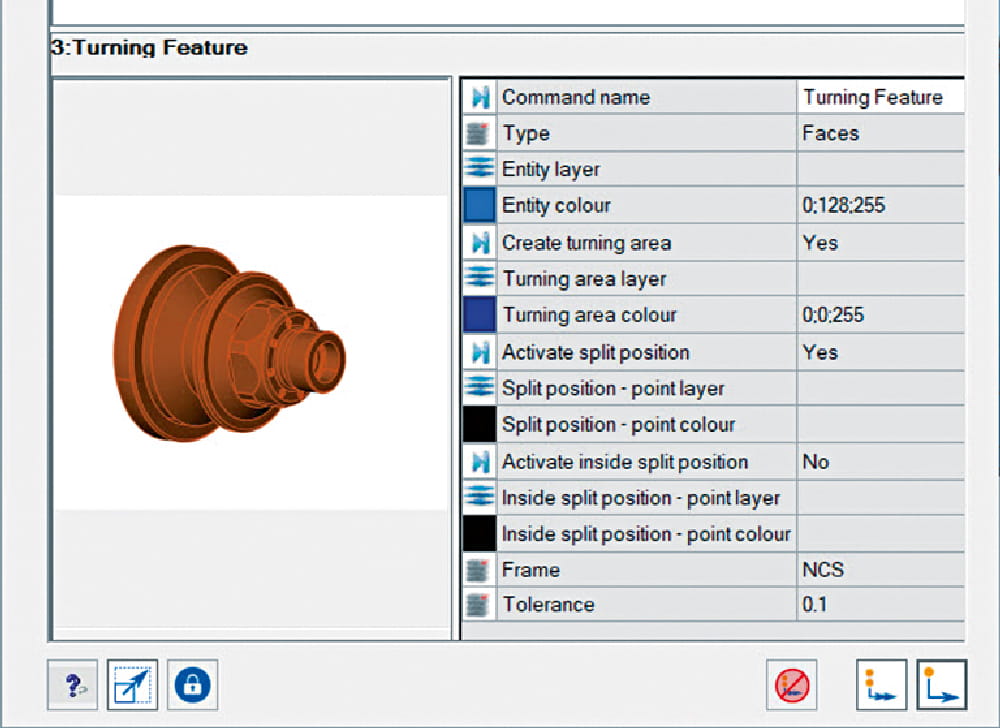

    • Support for turning features
      Turning features are now fully usable in the hyperMILL® AUTOMATION Center.

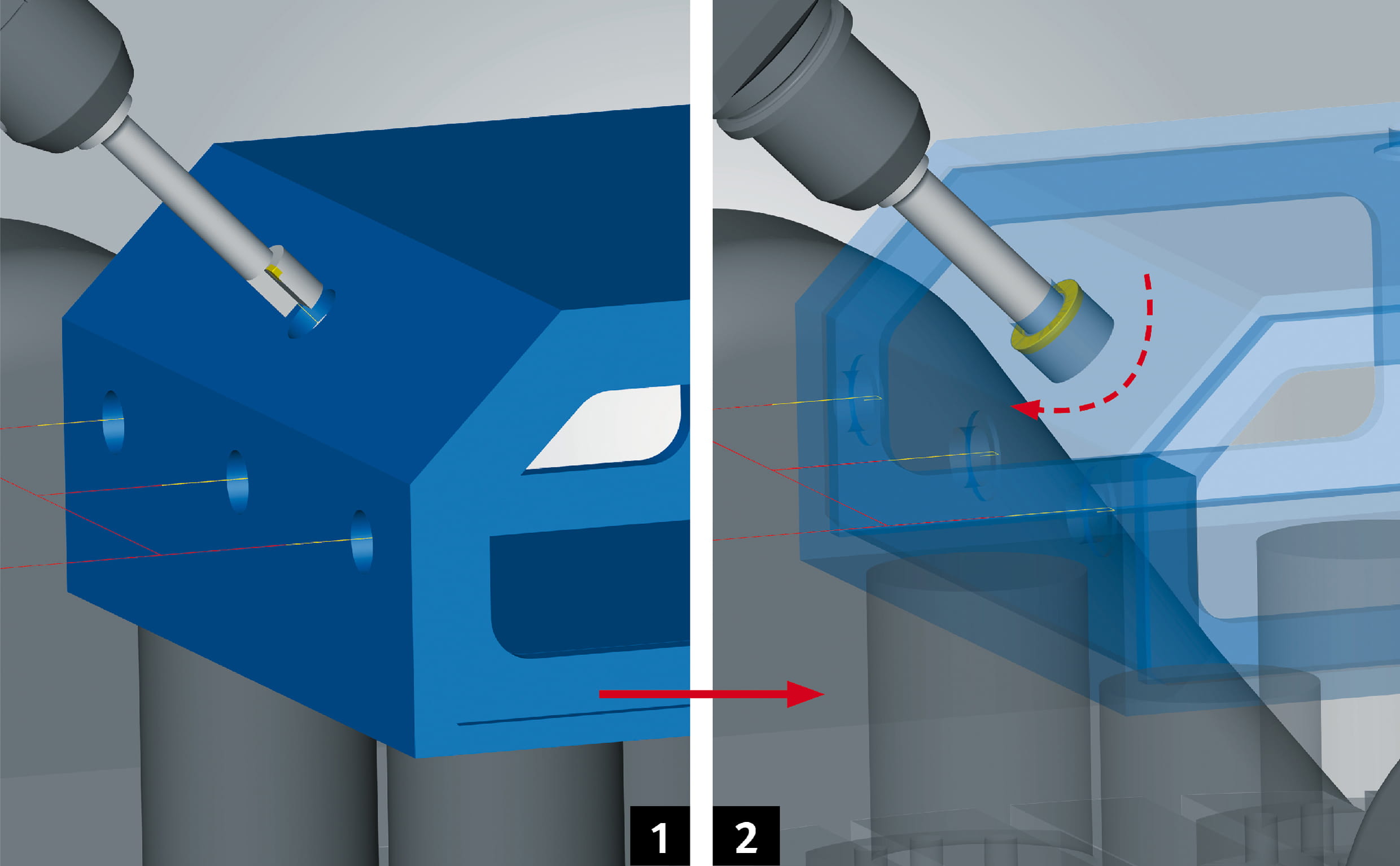

2.5D Back Boring
This new strategy enables back boring tasks to be programmed on machines with different kinematics conveniently and easily. Tool holders and inserts, as well as monobloc tools, are displayed one-to-one in the virtual machine and checked for collisions. This ensures the highest level of safety for this critical type of machining.
Benefit: Simple and reliable programming for back boring.

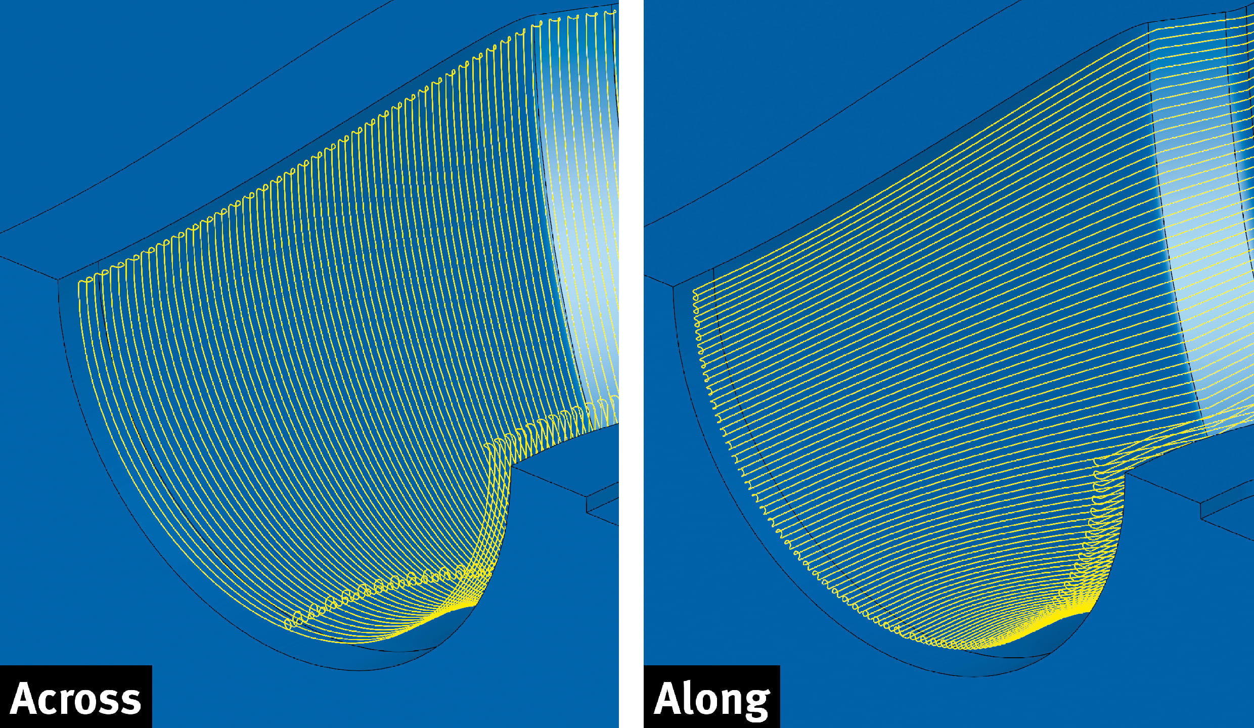

5-axis halfpipe machining
This strategy makes programming high-quality toolpaths for halfpipes and tubes convenient. The user interface is designed to be easy to use and intuitive. The calculation mode of this strategy enables a wide range of applications and ensures the best possible quality of the output toolpaths. Sharp edges, for example, are accurately mapped, and surface quality and precision are thus ensured in these areas as well.
Benefit: Intuitive operation, high quality of tool paths, wide range of applications.

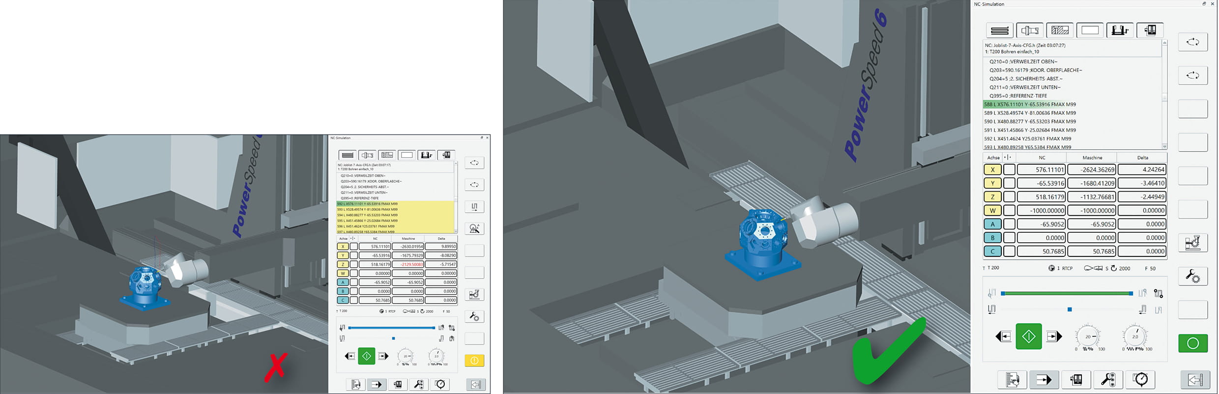

NC Optimizer – Optimization of additional axes
Manually positioning fixed rotary axes and parallel axes is very time consuming. In most cases, the user can only determine a suitable and collision-free solution for the machine kinematics by performing several tests.
Fixed rotary axes and parallel axes can now be optimized with the NC Optimizer, as it automatically finds a kinematically correct and collision-free solution. This also applies to machines with Hirth gearing. As a result, users will no longer lose time by manually interacting with the axes.
Benefit: Simplified programming.

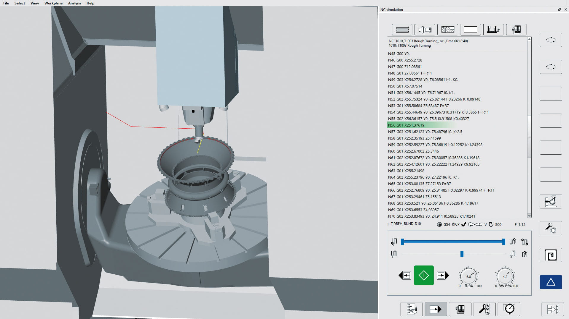

Support for mill-turn machines with Siemens control system
hyperMILL® VIRTUAL Machining now supports mill-turn machines with A/C kinematics. This means that both technologies are perfectly combined in one operating environment, and the user benefits from maximum safety and process control.
Benefit: Increased safety, process control, and efficiency.
