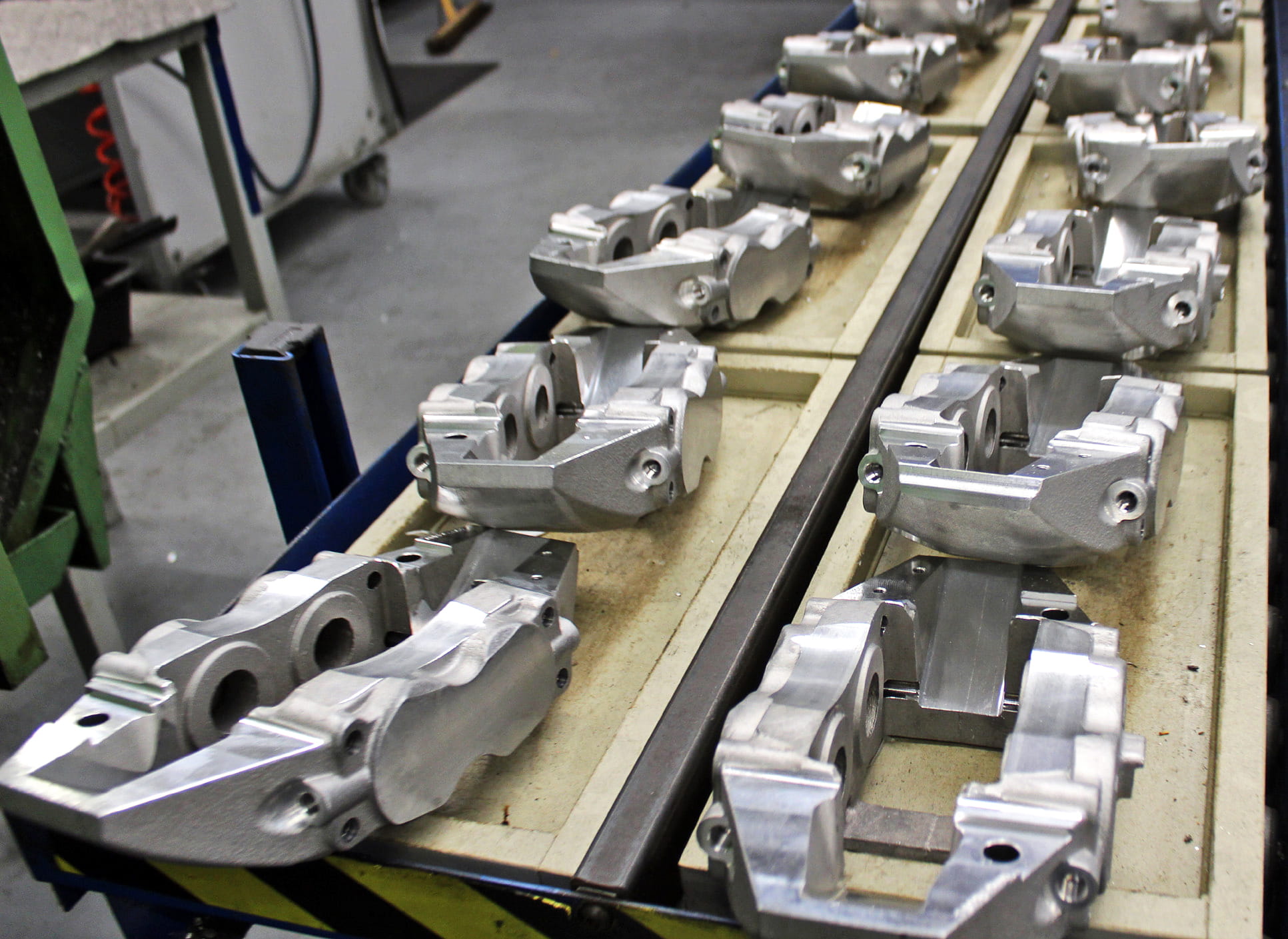

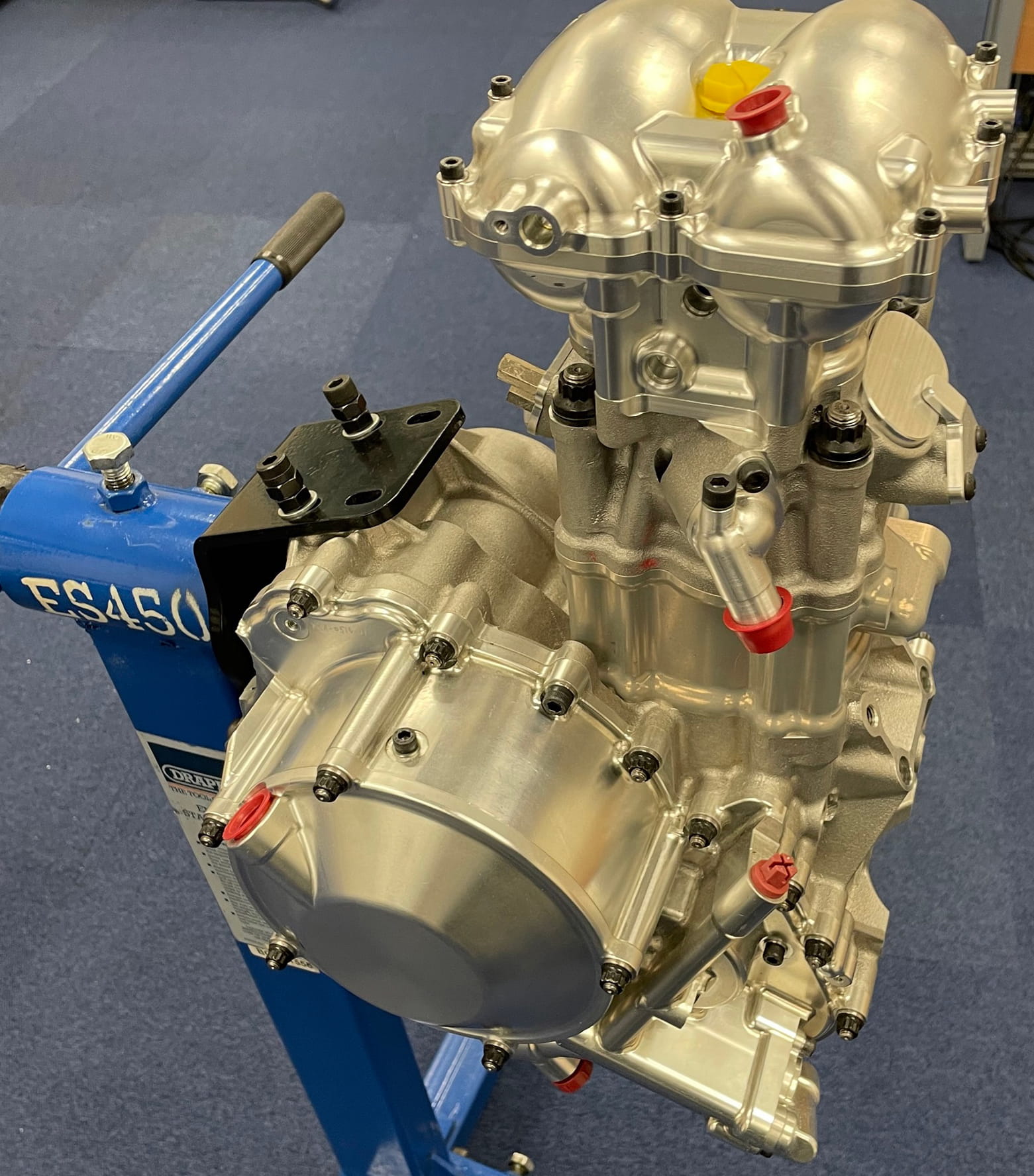

The company has been instrumental in a range of high-performance car and motorbike engine projects and present, the workload includes a dedicated cast iron machining cell for producing military brake callipers with the remaining 85% of the business having a mix of general automotive, motorsport and aerospace work. However, the bulk of the output focuses on high-end engine and gearbox components such as the head, block, bearing caps, inlet manifolds, covers and cases for a naturally aspirated niche V12 engine for supercars such as the Ferarri GTO. Nestled in the heart of the ‘motorsport valley’, the Northampton manufacturer has also designed, developed and manufactured a 250cc 4-stroke single-cylinder motorbike engine that conforms to the MOTO 3 rules and can compete in the MOTO GP Series.
Commenting upon the engine, Garry Edwards says: “We wanted to prove our capability by designing and manufacturing a MOTO GP engine from the ground up. The 52 horsepower unit was trialled and tested on the track against Honda and KTM units; the two leading powertrain suppliers in the class that had evolved their designs over years of development. Our very first engine without re-development work was faster than one manufacturer and slightly slower than the other – a great testament to our engineering expertise. Sadly, to bring a race engine to production requires huge financial support beyond the realms of a subcontract manufacturing business.”
Garry adds: “As a demonstrator, the engine really does show our capabilities where we are using full 5-axis simultaneous machining, machining from solid billets and sand castings, so we encompass everything in terms of where our capabilities are. Quality is very important at Alcon Precision Engineering; we want to stand out with quality being our primary focus along with customer focus. Everything we’ve manufactured since 2007 has always been about quality, the appearance of the parts, the functionality, and we also want to ensure we are giving the best possible service to our customers.”

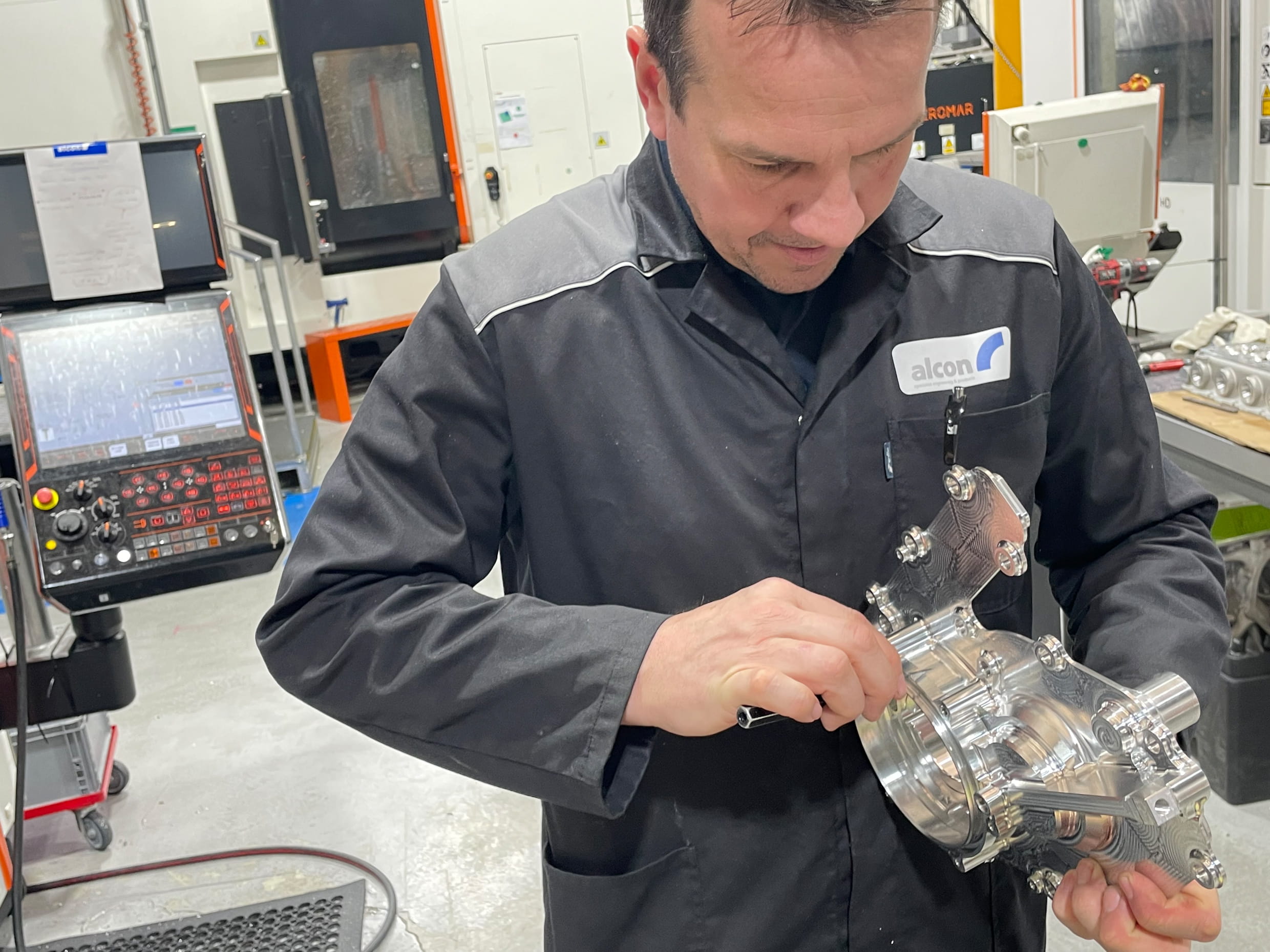

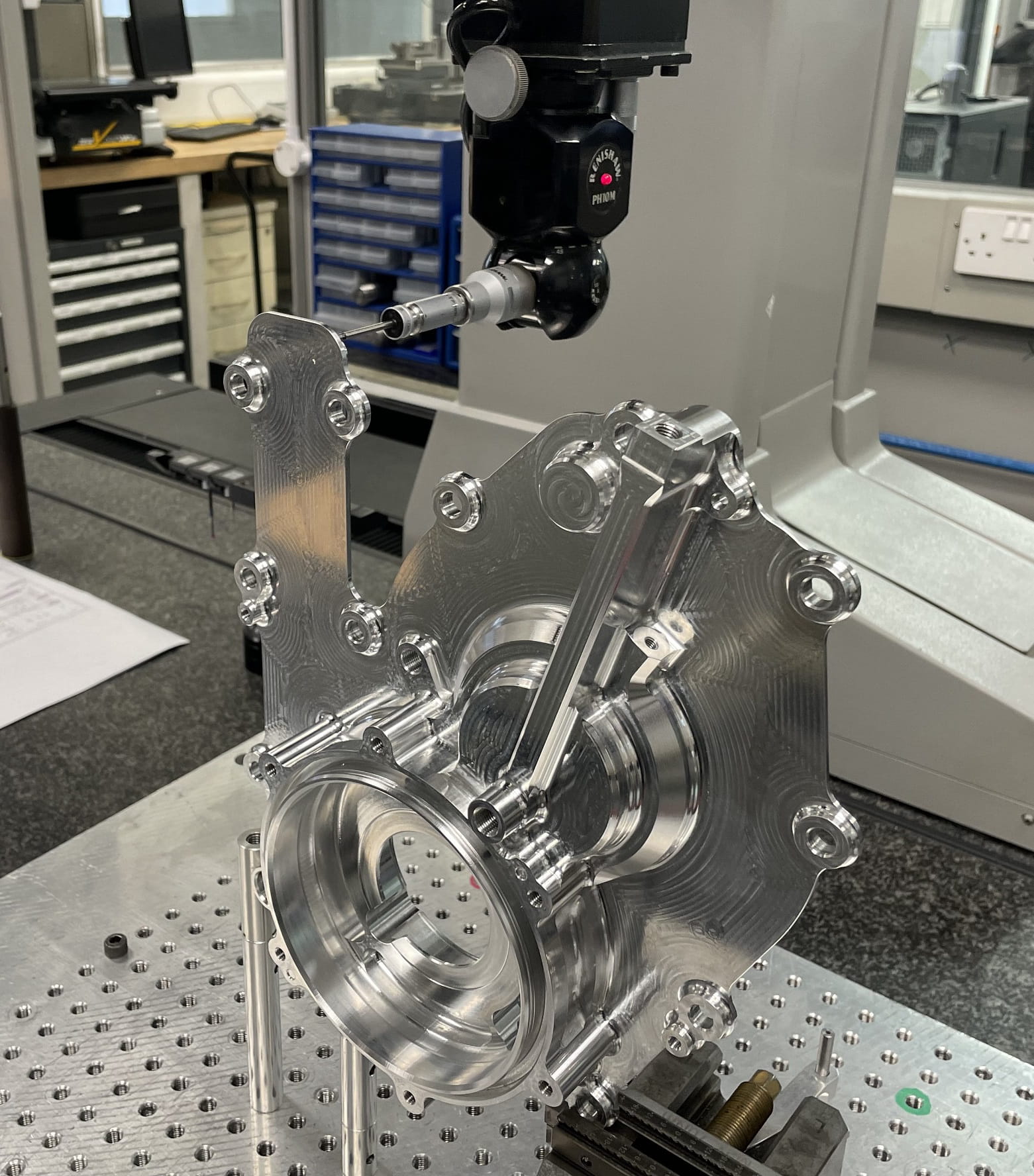

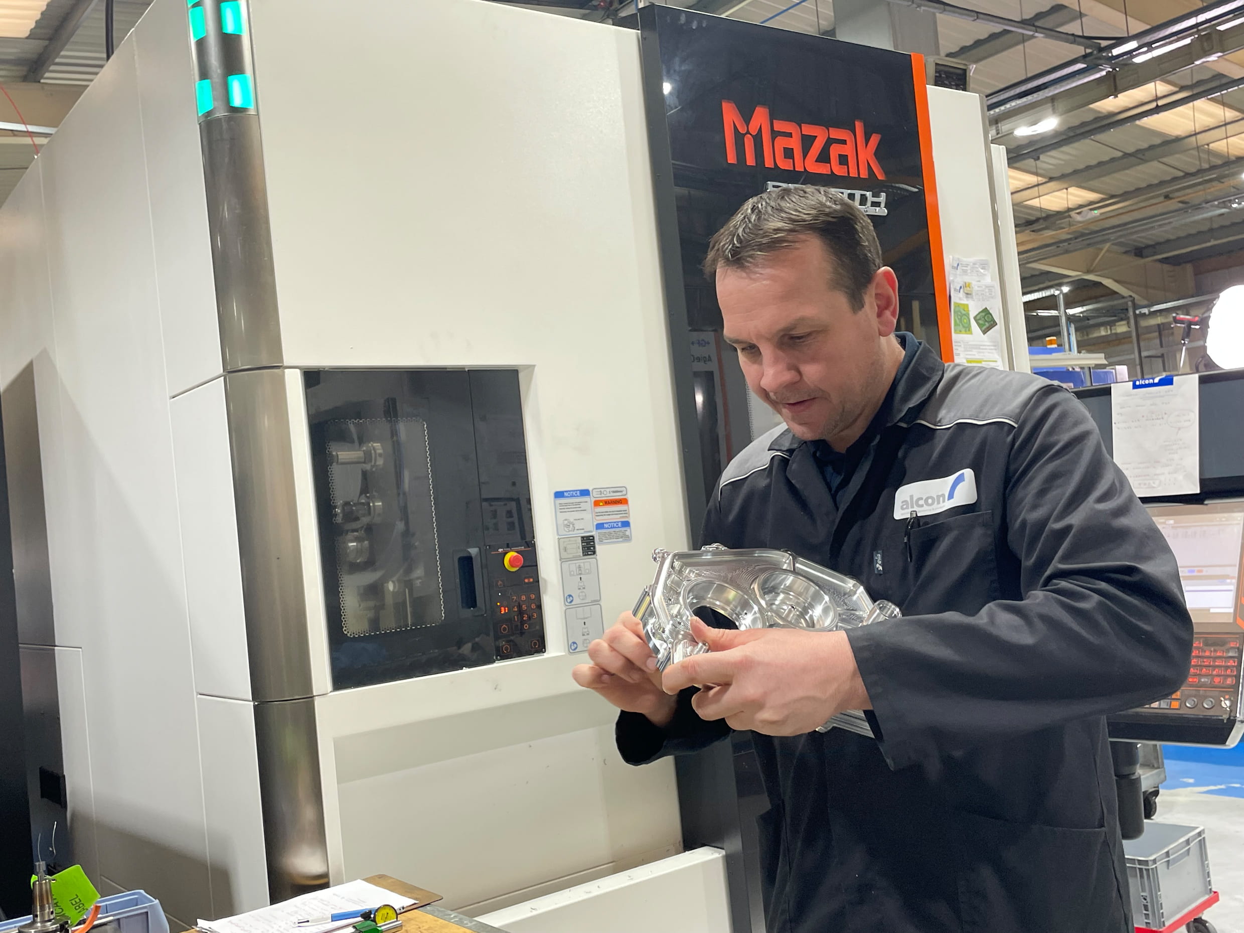

 – Complex high precision motorsport engine part produced by Alcon Precision

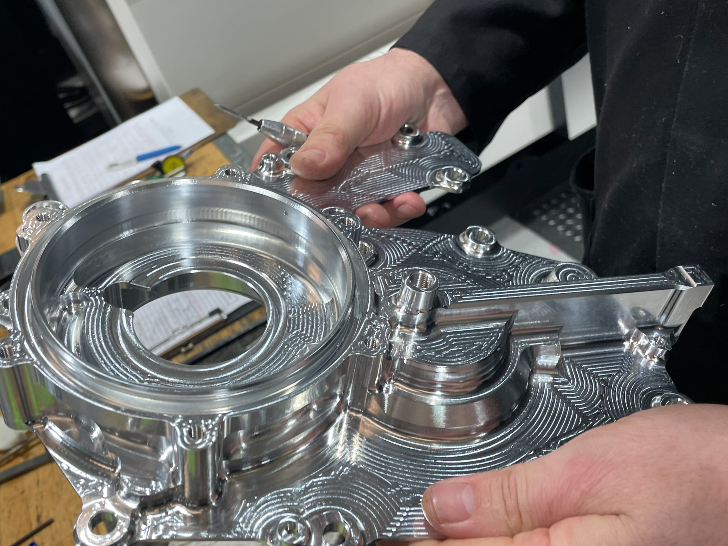

Adding to this, Alex Hodgson, Business Development Manager at Alcon Precision Engineering says: “Typically with 5-axis machining, you close your doors to certain industry sectors. This is due to the time and complexity involved in machining components. Our new manufacturing systems are so technologically advanced, and in particular, our CAM package, but it enables us to produce parts within surprisingly low-cost brackets that look just as beautiful as premium parts. We are trying to develop an aesthetically perfect-looking engine and to do this we had to dig deep into 5-axis machining. When you do this, you encounter step-over and crossover lines that are created by the cutting tools. This was overcome by our CAM package, it allowed us to look into detail at our tool paths and stepovers, so we could use a smooth blending feature within our CAM package. All of this comes together to create an aesthetically perfect part.”
Confirming this, Garry says: “A major benefit that stands out is the tool paths within the Surface Machining feature. Parts like engine covers need to be aesthetically perfect and with hyperMILL®, if the middle of the cover or part is shaped like a flower, for example, you can select this central shape as a guide for the entire toolpath. This will ensure the entire toolpath follows the contours of the part to perfectly blend the surface. Comparing this and other features – hyperMILL® is a world apart from other CAM systems.”
