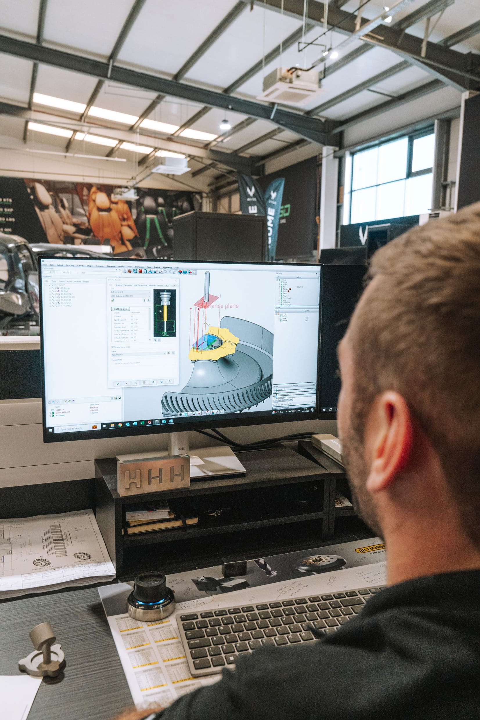

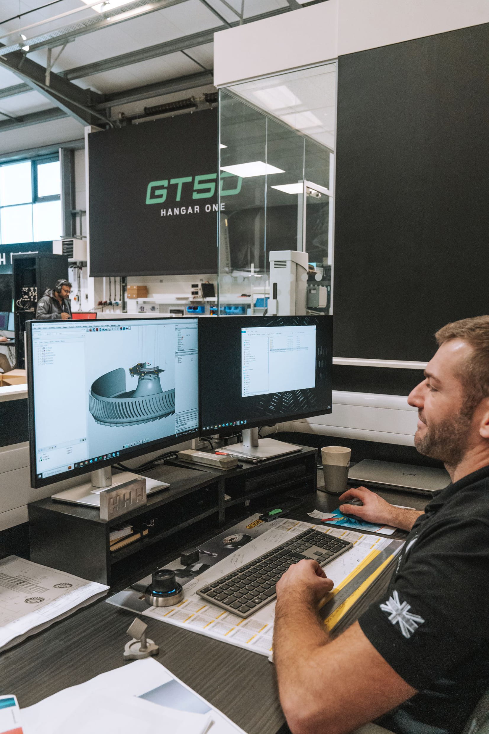

Using hyperMILL® together with the VIRTUAL Machining Optimizer, Hill Helicopters now simulate full NC-code, optimize toolpaths, and verify complex components virtually. The result is faster development cycles, fewer machining surprises, strong confidence in early part production, and an ability to handle the pace and scope required for bringing HX50 closer to flight.

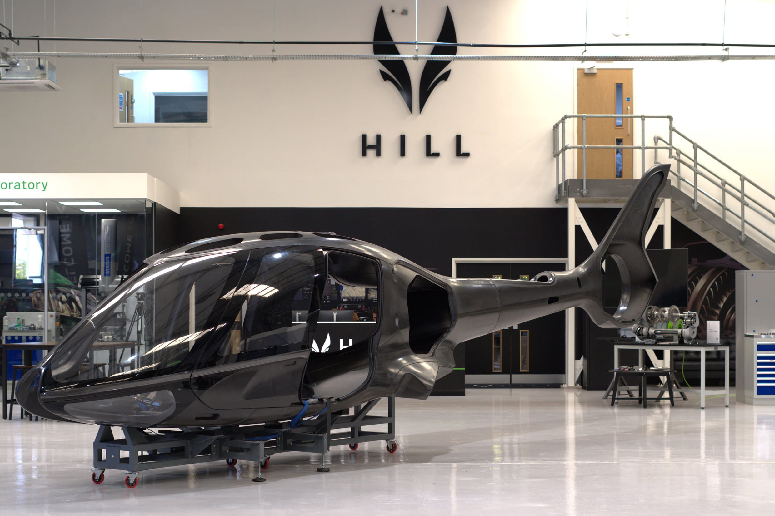

Discussing the foundation blocks of the Staffordshire manufacturer, Company Founder, Chairman and Chief Engineer at Hill Helicopters, Dr Jason Hill says: “Hill Helicopters are designers, developers and manufacturers of the HX50 5-seat turbine light helicopter. We are actually bringing light helicopter manufacturing back to the UK for the first time in 50 years. To sell an effective general aviation light helicopter, you really have to match the price point with high-end supercars. To do that, you really can’t turn to the existing aerospace supply chain. So, we’ve had to develop a vertically integrated manufacturing strategy where we manufacture everything in-house from scratch.”

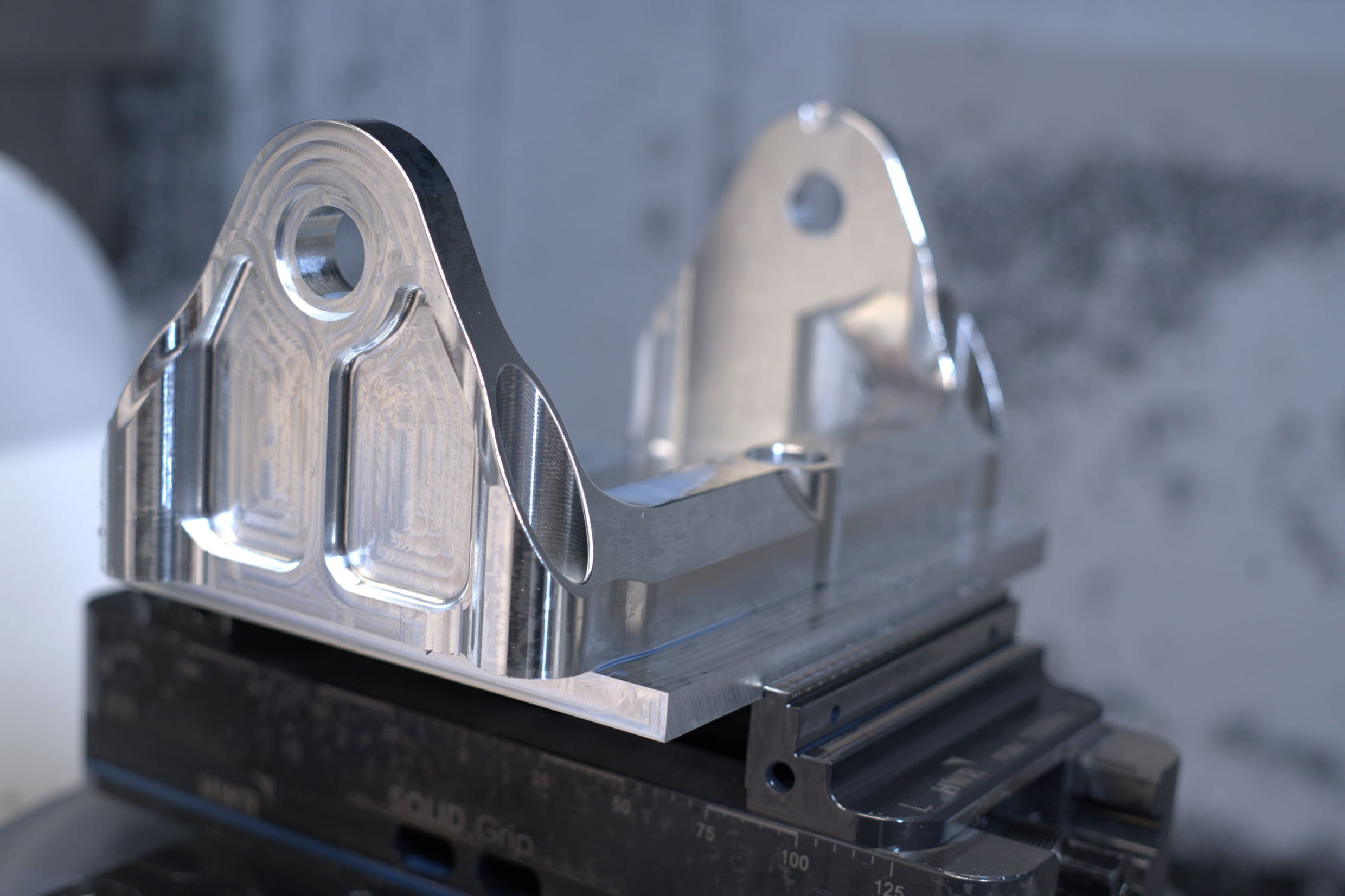

“We program milling and turning with hyperMILL® and it is absolutely instrumental for us to be able to rapidly develop literally, hundreds of complex components in a wide variety of materials to extremely tight tolerances.”

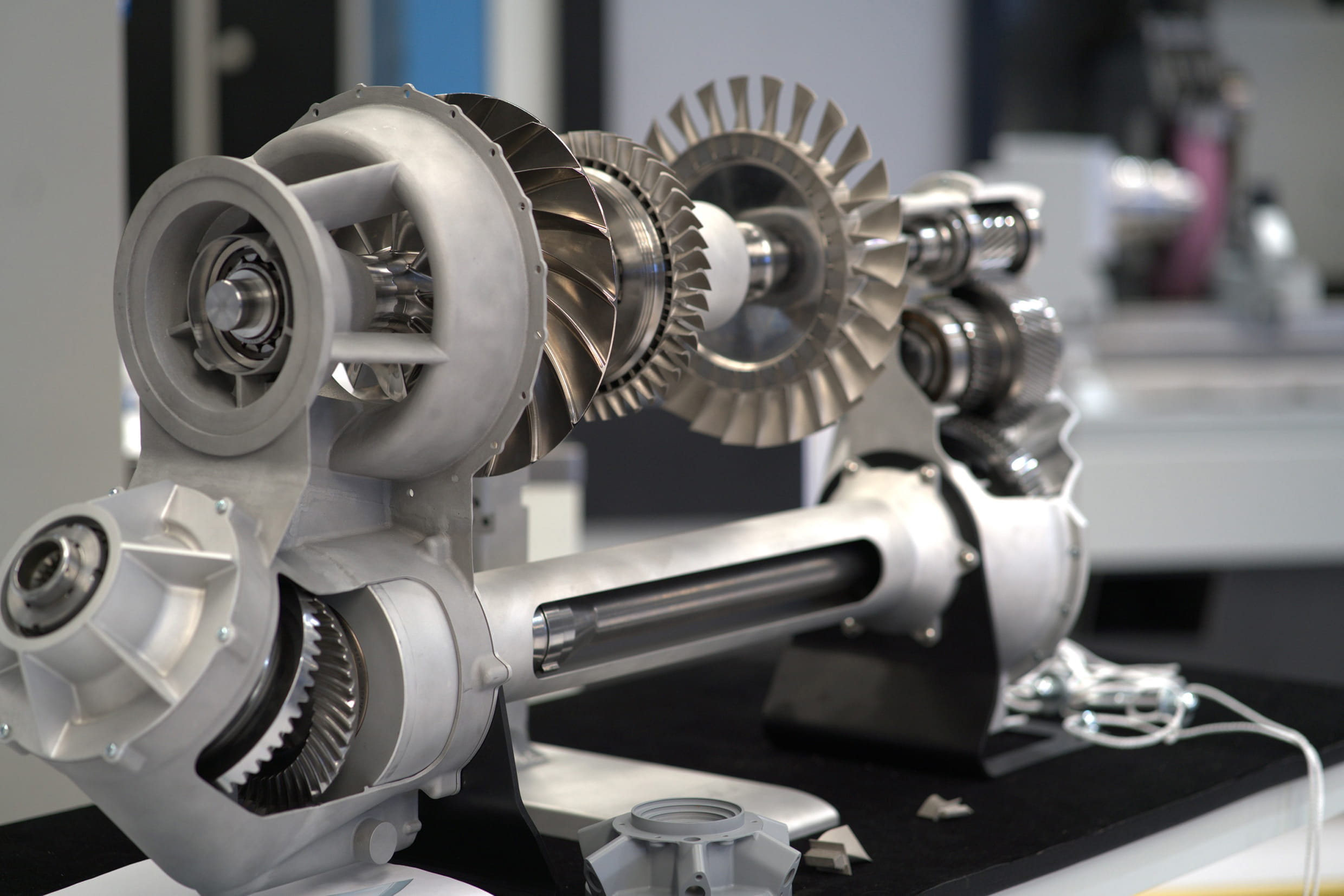

Discussing the start of the relationship between Hill Helicopters and OPEN MIND Technologies UK, Justin Talboys-Cotton from OPEN MIND Technologies UK says: “We were initially invited by Hill Helicopters to look at their compressor wheel, which is effectively an impeller. It was a very challenging component with very small gaps. It was a challenge they gave us, but from that point on, there has been a wide variety of parts the company wants to make. From there, the relationship has grown and as Hill Helicopters have bought more equipment and machine tools, they have increased their usage of hyperMILL®. Being invited into Hill Helicopters at such an early stage - before machines and programmers were here, it has been really exciting to be part of this helicopter development program and watching it grow.”

Commenting upon the current stage of development, Dr Jason Hill says: “Fundamentally, at this stage, our sole objective is to get through the development of parts and sub-systems as fast as possible. Pretty much everything we do on every single machine here is a first-off, a one-off. So, we must manage the risk of programmer error or machine crashes as we are going through these development phases at pace. The capability within hyperMILL® is absolutely crucial to us being able to do that with minimum risk and the maximum confidence possible - as quickly as possible.”

Justin Talboys-Cotton from OPEN MIND adds: “The hyperMILL® VIRTUAL Machining Optimizer enables the customer to cover things like rewinding automatically on the gantry mill. As a programmer, this means you program as normal even though the machine is complex. Having the Digital Twin set up and the Optimizer module, we automatically ensure the processes are collision-free and it can run within the machining envelope comfortably. I believe the main aim here in regards to being efficient, is managing lots of parts and lots of design changes that are involved with the components passing through the process chain for the first time. hyperMILL® is enabling Hill Helicopters to really optimize their programs, first of all as prove-out for ‘fit for function’ but also to make sure the parts are going to be valid for the production environment as well.”
Adding to this, Dr Jason Hill comments: “We program milling and turning with hyperMILL® and it is absolutely instrumental for us to be able to rapidly develop literally, hundreds of complex components in a wide variety of materials to extremely tight tolerances.”
