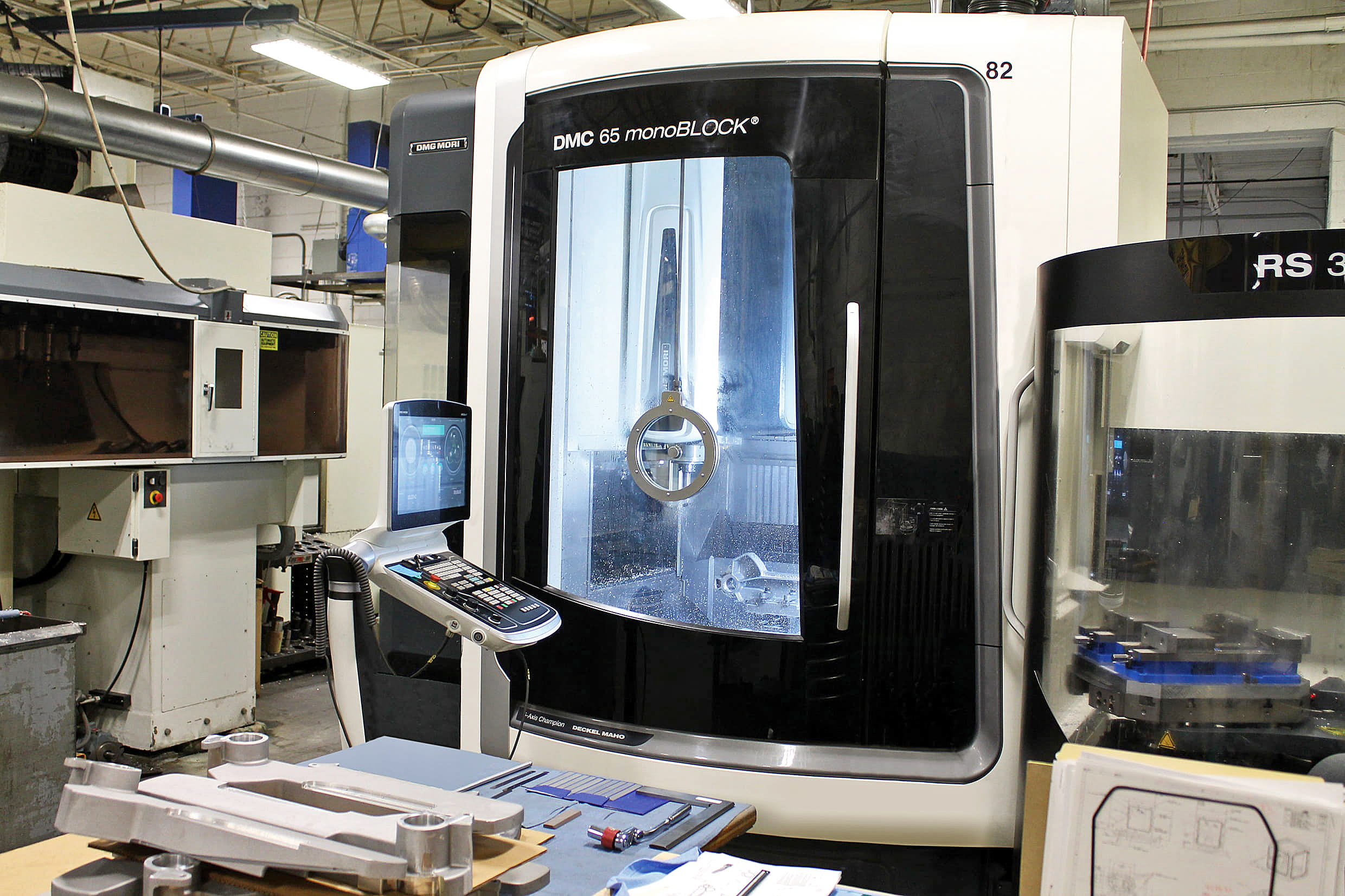

Evans has 3-and 4-Axis machines, but 5-Axis is its mainstay. Dan Golomb, Chief Technology Officer and Mechanical Engineer at Evans has been with the company for fourteen years and during this time he has seen their fleet of 5-Axis machine tools expand, beginning with smaller DMG machines and now adding larger, more powerful DMG machines increasingly equipped with automated pallet changers, capable of machining huge parts in only one or two operations.
“The largest DMG has 82" x 82" travel,” Golomb said.

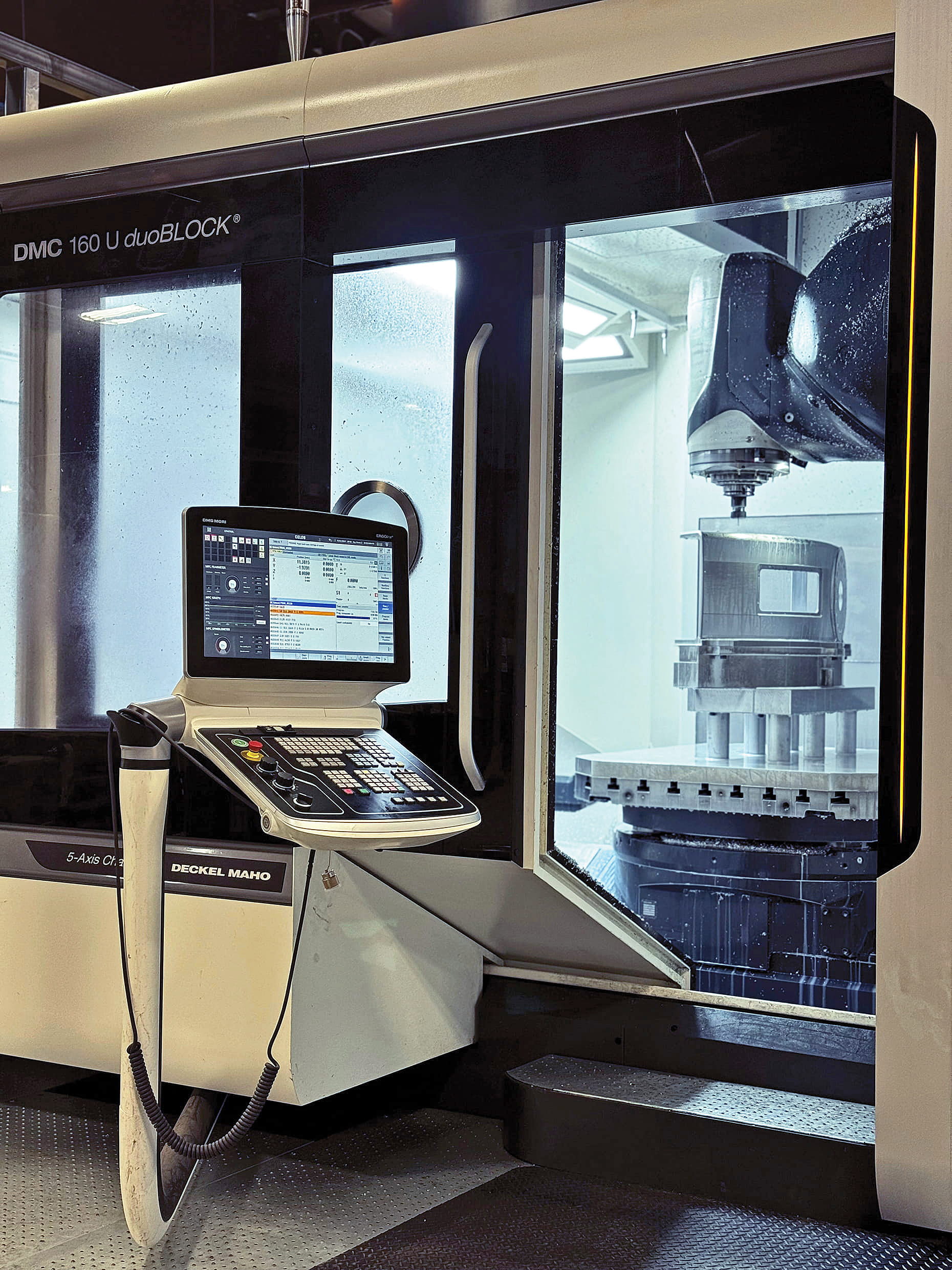

 – The powerful, large DMG 5-Axis machine with efficient strategies from <em>hyper</em>MILL<sup>®</sup> CAM software reduces machining time by approximately 50% compared with the previous machine and software.<br /><em>Photo is courtesy of Little Enterprises North and Evans.</em>
The powerful, large DMG 5-Axis machine with efficient strategies from hyperMILL® CAM software reduces machining time by approximately 50% compared with the previous machine and software.

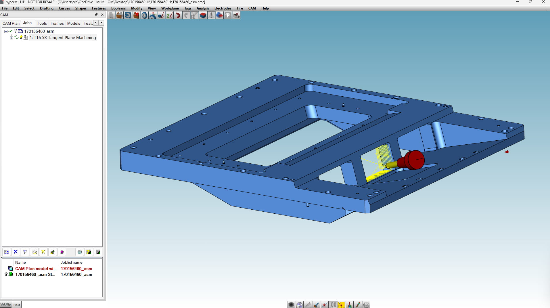

With both Little Enterprises North and Evans using hyperMILL®, the stage has been set for big productivity gains. Golomb commented that there are many benefits to using hyperMILL® including being able to program at a higher level, “Programming is straightforward, easy and fast – the software is intuitive and expedites programming by automatically identifying where the part is within machine travel limits, and streamlining processes such as 3 plus 2, 5-axis simultaneous, optimized roughing, simulation and more. Having our team trained with using the same software saves at least 25% of programming time, and machining time has been cut in half due to hyperMILL® efficiencies.” For example, in one of the first jobs where Evans used hyperMILL®, machining time was reduced from 12 ½ hours to about six.
Anastasio echoes Golomb and adds that he has seen 50-60% machining time savings when using hyperMILL® integrated with SolidWorks. “After creating the stock and modeling the fixture, I leverage the tool database for a working definition of the tools. The overall programming process is very user friendly and I know how far off center I can be and yet still be within the travel of the machine. I would estimate I save 30-40% of programming time on the front end and realize significant cycle time reductions, yielding much better parts. “

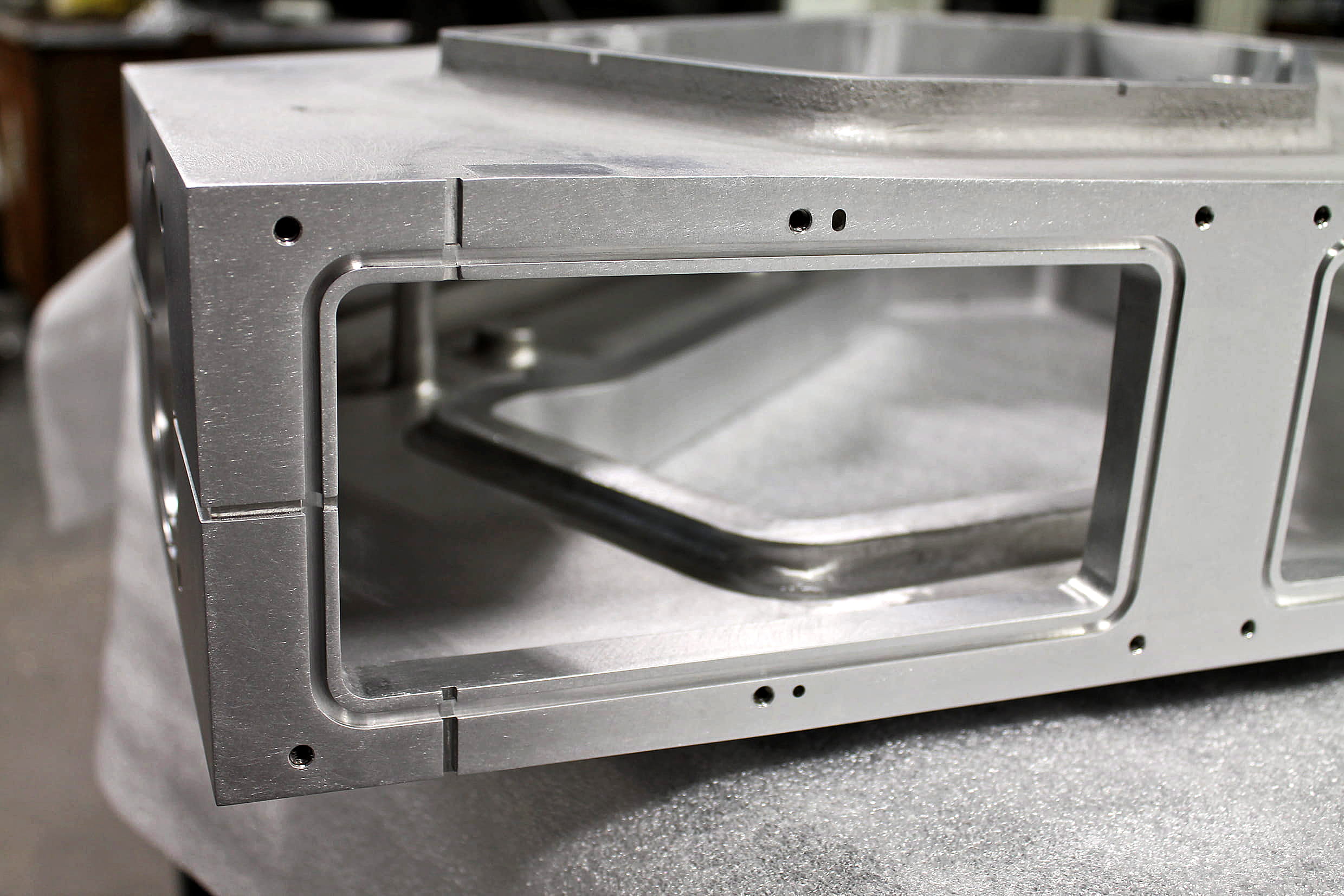

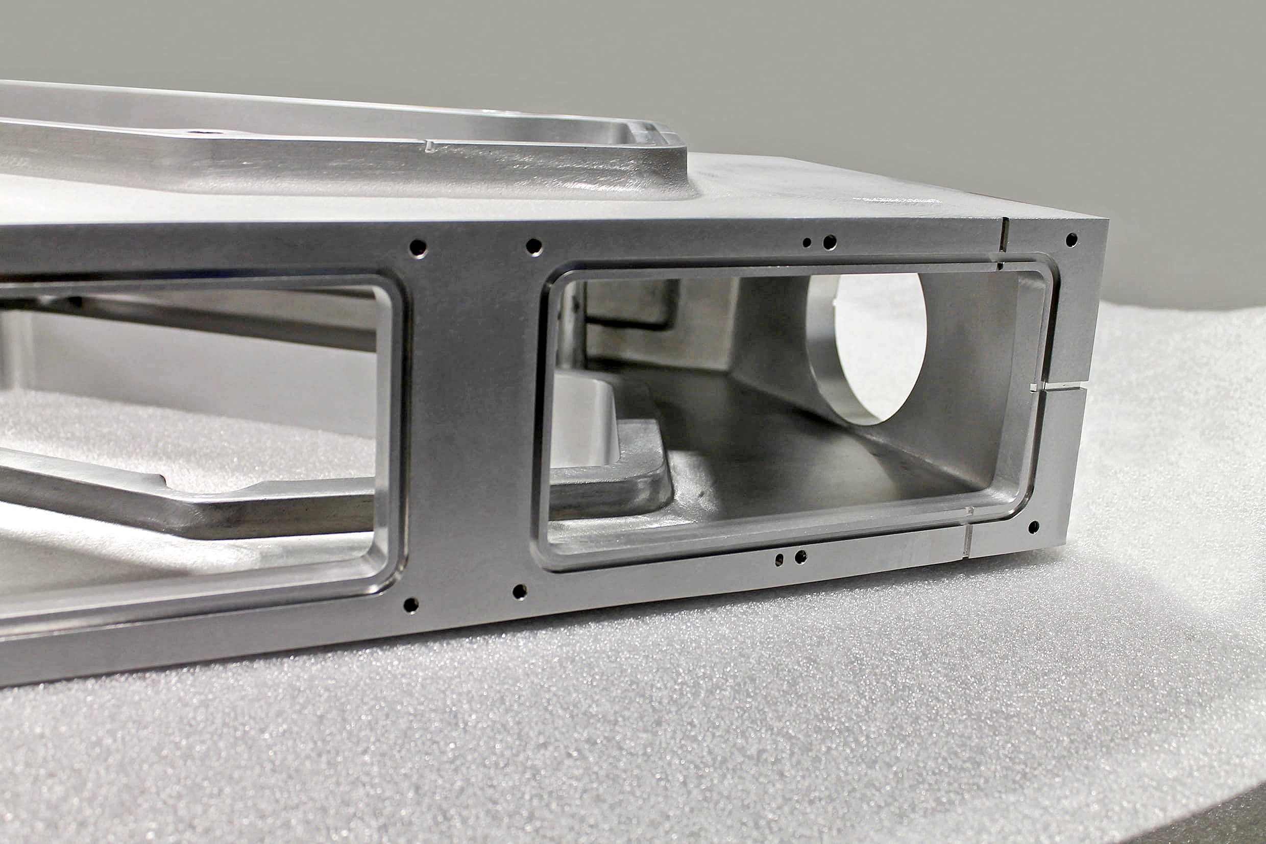

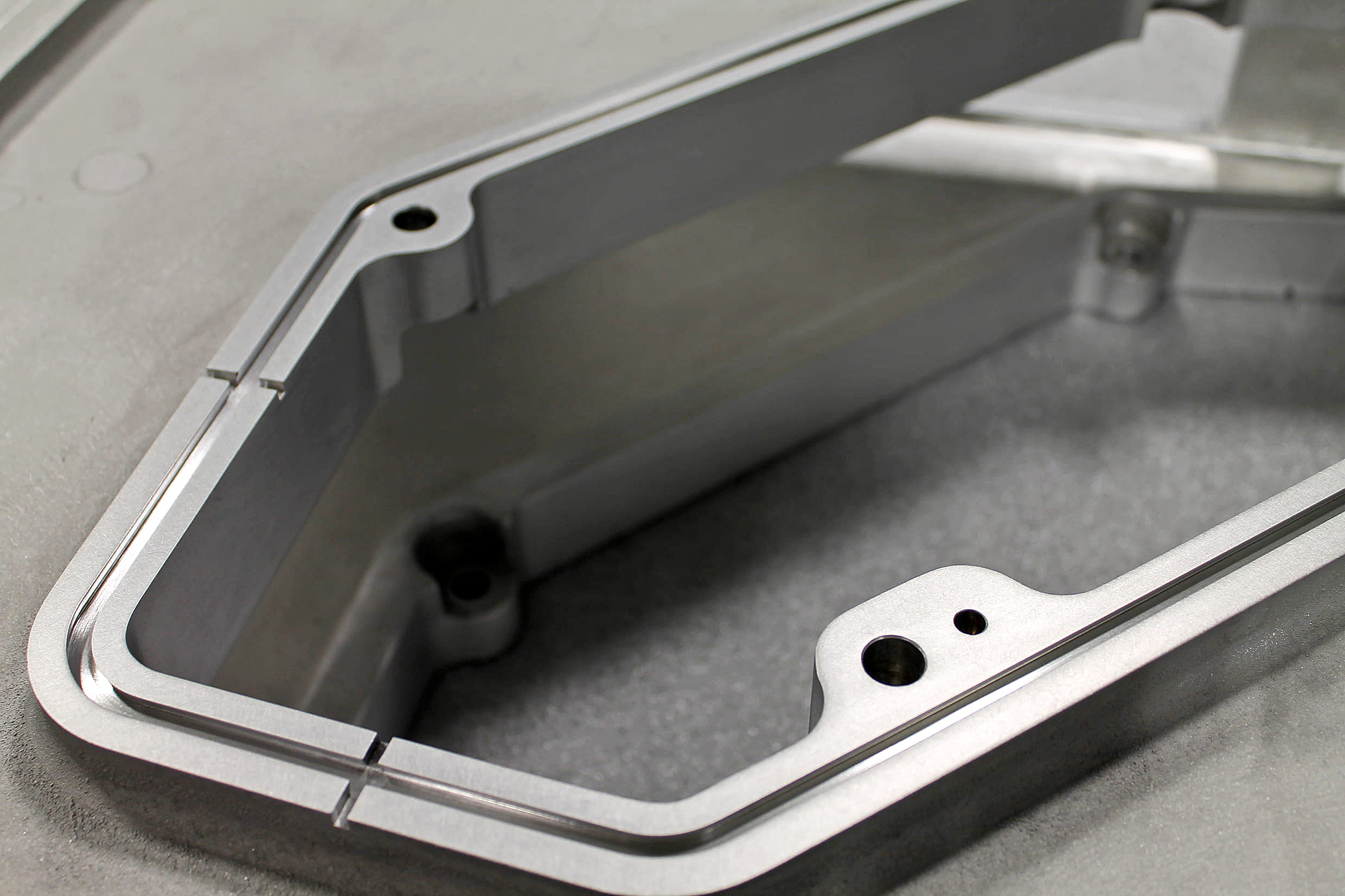

Machining semiconductor parts includes deep pockets with small, hard-to-reach internal corners.

On average, the semiconductor and medical parts that Little Enterprises North and Evans are manufacturing require an accuracy of +/- .005" and tolerances to +/- three tenths. The parts also have complex geometric dimensioning, surface profiles, perpendicularity, true position, as well as flatness. “We are working with everything from forgings/castings to billets, and machining a lot of deep pockets with small internal corners that are hard to reach, in addition to cross holes and complex surface profiles,” said Anastasio.
One of the semiconductor chambers starts from a 7,000 lb billet and is machined down to 450 lbs. Golomb said, “Using a powerful and large DMG 5-Axis machine with the efficient strategies and toolpaths from hyperMILL®, we were able to reduce the machining time to approximately 13 hours per part compared with 23 hours per part when using an older machine and different software.”

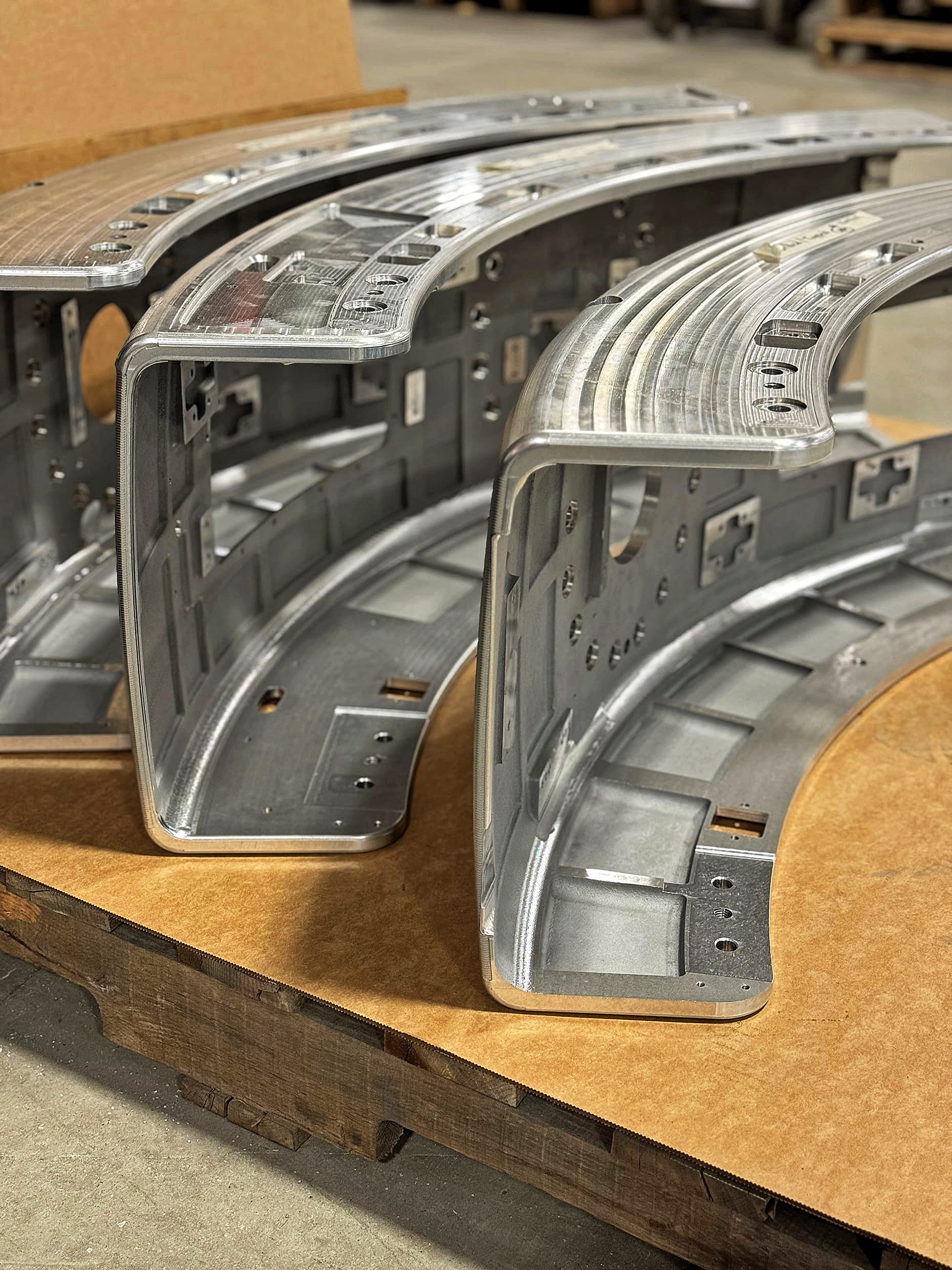

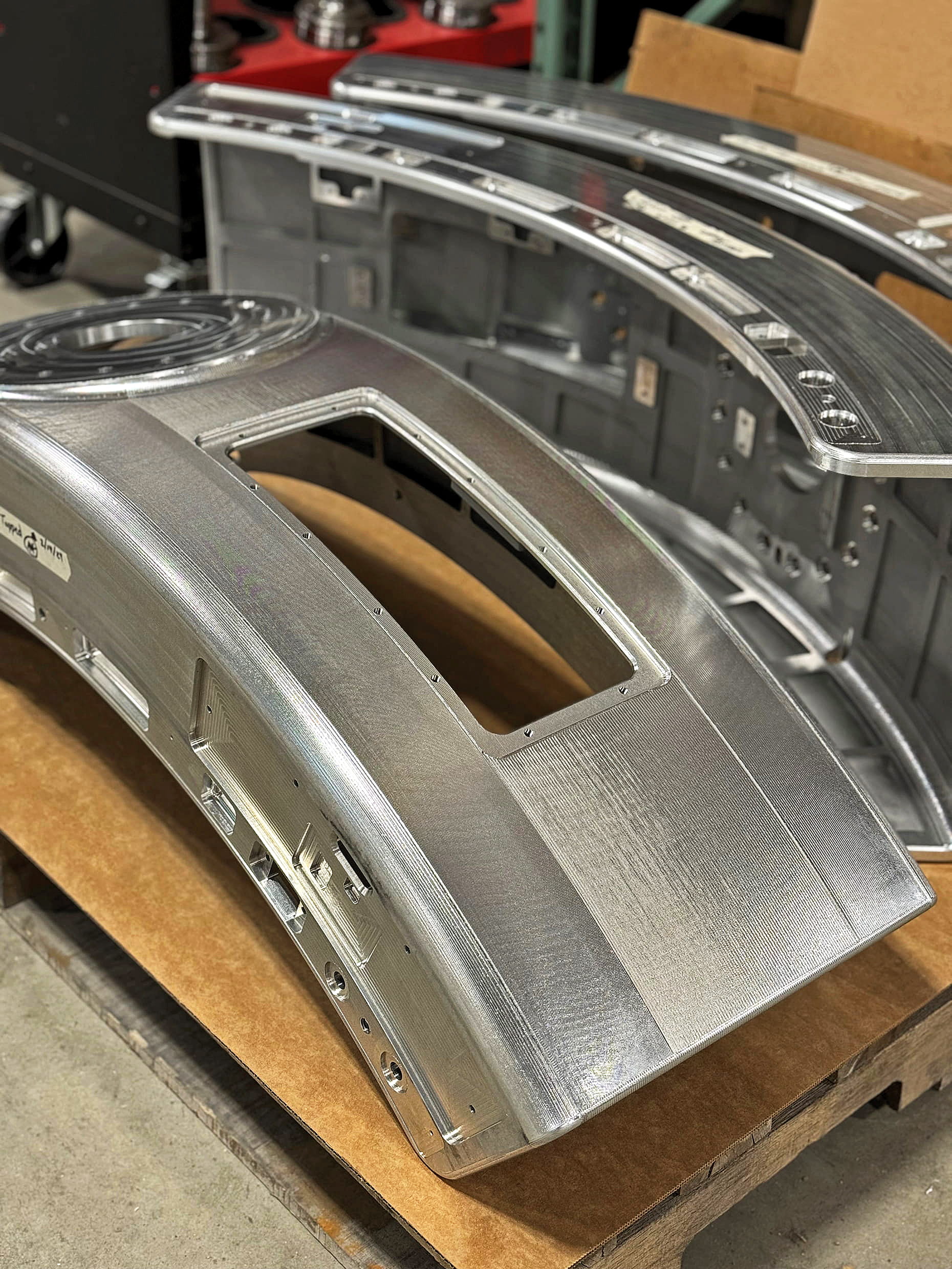

In the case of a medical part which goes into the assembly of a mobile Magnetic Resonance Imaging (MRI) robot system, the machining process starts with two 66" diameter sand castings which are machined to remove approximately 80% of the material and include large surface areas and several holes, providing the interface for interpolating MRI components to the robot base. Previously, Little Enterprises North needed multiple operations to complete the medical part on several vertical machining centers to reach all the holes. Now, one larger 5-Axis machining center supported by hyperMILL® programming and EMUGE-FRANKEN Circle Segment end mills has reduced machining time by 50% to perform the job in one operation.
 – Medical assembly part is machined in one setup on a large DMG 5-axis machining center.<br /><em>Photo is courtesy of Little Enterprises North and Evans.</em>
Anastasio said, “The medical part has a complex surface with multiple and variable radii that need to blend together. Previously it was taking us 12 ½ hours using ball mills for the application which included accessing deep pockets. Now using Lens and Tapered Circle Segment end mills and hyperMILL® , machining time has been reduced to six hours and the surface finish is excellent.”
