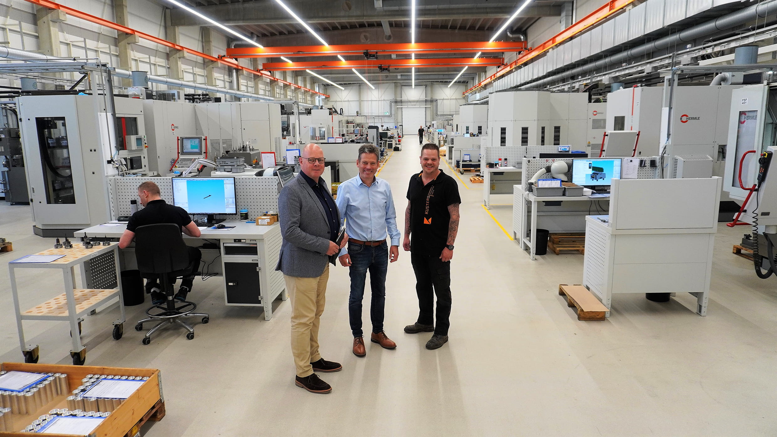

Stefan van Aalst, OPEN MIND, Olaf Heijers and Johan van den Heuvel (from left to right) in the modern, automated workshop at Kusters Precision Parts. The hyperMILL® programming stations can be seen in the background.
Image: Kusters Precision Parts
