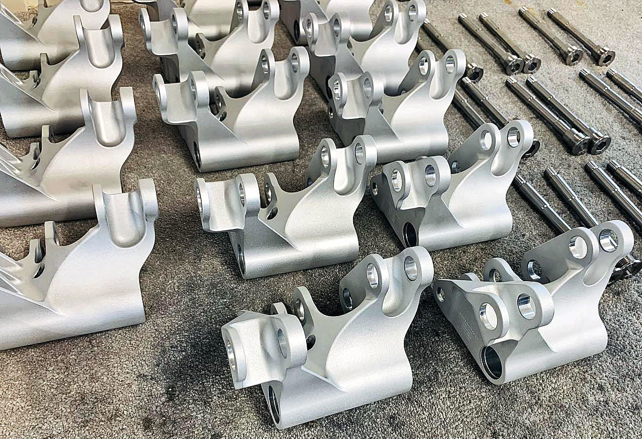

 – Motorsport components programmed and machined with <em>hyper</em>MILL<sup>®</sup>
Motorsport components programmed and machined with hyperMILL®

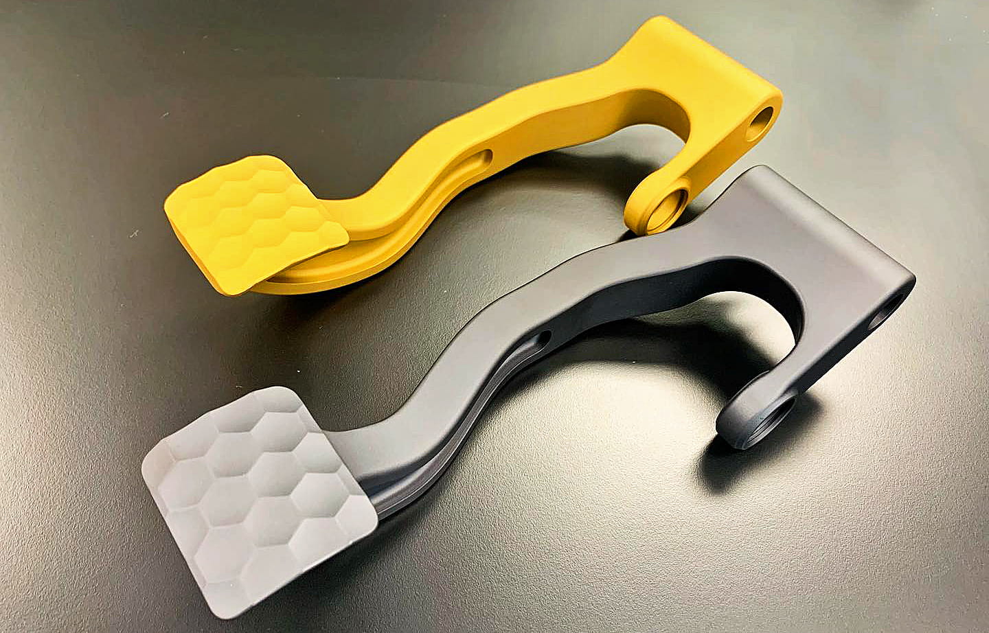

 – Motorsport Pedals machined at IML

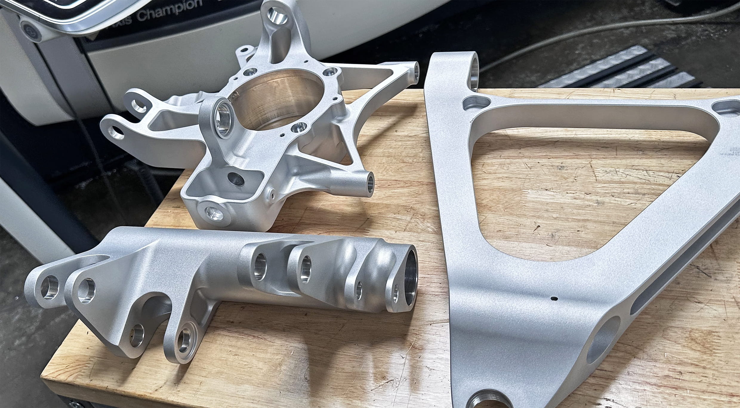

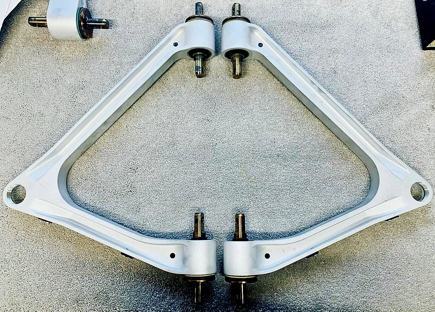

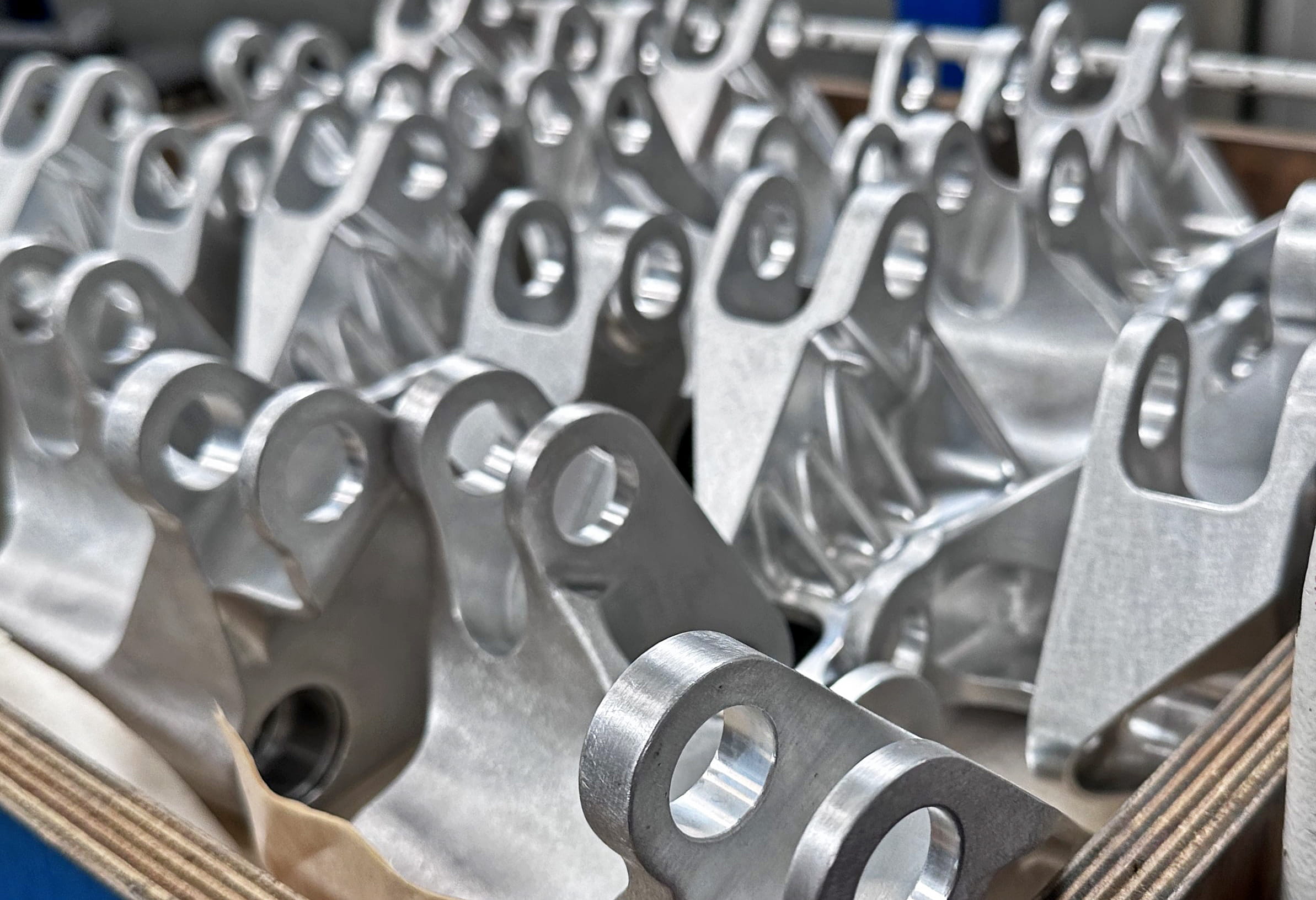

 – A selection of complex parts machined with <em>hyper</em>MILL<sup>®</sup> at IML&nbsp;UK
A selection of complex parts machined with hyperMILL® at IML UK
