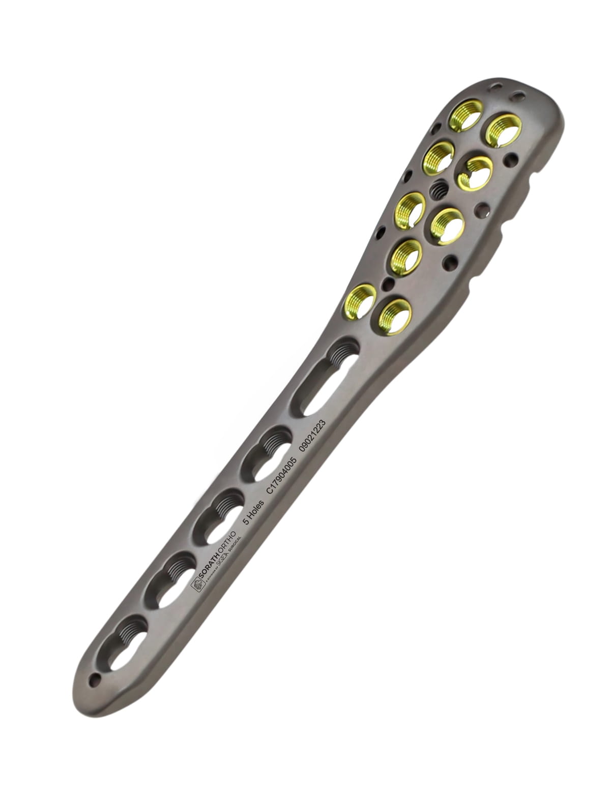

Producing bone plates under its own brand, ‘Sorath Ortho’, Sigma is also a leading international contract manufacturer of medical devices. Sigma Surgical's portfolio includes 615 different implants SKUs (Stock Keeping Units) with variations, amounting to 32,000 different parts. Additionally, there are 1,200 instrument SKUs and 440 variants of general instruments. The company's extensive range demonstrates its market significance. It produces 1.1 million bone plates along with 38,000 instruments and 11,000 general instruments annually in a facility equipped with 63 CNC machines, including 14 five-axis machines, operating 24 hours a day. Explaining these impressive figures and diversity, CEO Mehul Gothi states: “For one customer, we produce knee replacement sets with over 290 different component types, and the next customer will have an additional 120 variants, totalling 16,000 SKUs just for knee replacements. A popular product is Distal Femoral Plates, which we produce in volumes up to 28,000 a month, while a clavicle hook plate may only require 200 parts per month.”

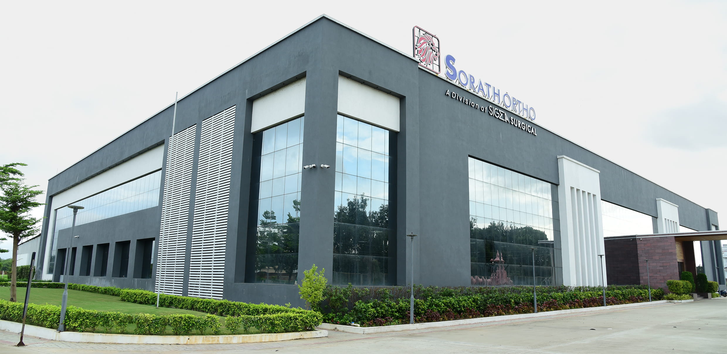

The Sigma Surgical state-of-the-art facility in Gujarat state, Western India

Adopting advanced finishing strategies such as 5-axis Tangential Machining from the hyperMILL® MAXX Machining Performance Package greatly enhanced surface quality on curved shapes. Transitioning from multiple processes and setups with plates to 5-axis simultaneous machining with hyperMILL® from solid billets improved throughput, surface finish, and decreased secondary hand polishing and rework.
Barrel Tool Tangent Machining strategies proved particularly effective for Sigma's bone-shaped implant profiles. Programming Manager at Sigma, Mr. Chaitanya Deshpande, notes: "Many of our implants have profiles matching bone shapes, and barrel tools are ideally suited for these applications. Our step-over distances increased from 0.1mm using ball end mills to 1mm with conical barrel tools, dramatically reducing surface scallops, cycle times and improving tool life. This hyperMILL® MAXX Machining HPC strategy delivered a 15% reduction in tool consumption by utilizing the entire flute length rather than just the tip, enabling 24-hour unmanned operation by enabling our 8 to 10 tool changes per implant to last the full 24 hours.”

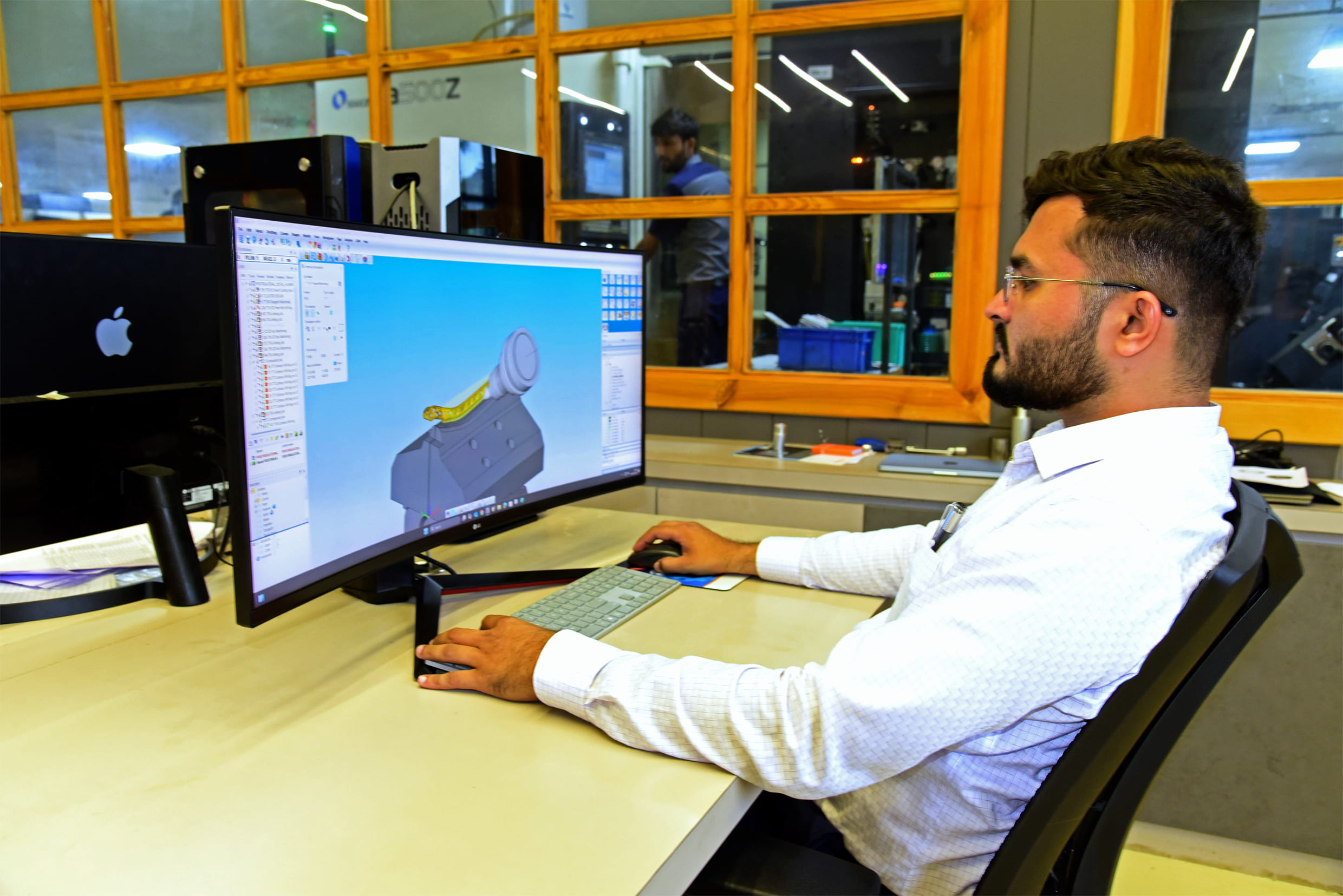

One of the most significant improvements with hyperMILL® was in programming efficiency. Mr. Chaitanya Deshpande reports: "Programming time was reduced by approximately 30% with toolpath generation for complex bone plates dropping from 6-7 hours to around 4 hours, allowing faster turnaround on new components. This is credit to the intuitive programming interface and efficient 5-axis strategies, which are now freeing up our programming resources to focus on more complex projects and accelerate time-to-production for new designs.”
Cycle time reductions from optimized toolpaths and tool engagement strategies were equally impressive, as Mr. Chaitanya Deshpande states: "Cycle times improved by 20% to 30% with production cycles reduced from 60 minutes to around 40 minutes per bone plate. This enabled us to increase throughput without additional machine hours.”
 – Mr. Chaitanya Deshpande, Programming Manager at Sigma Surgical programming medical implants with <em>hyper</em>MILL<sup>®</sup>
Mr. Chaitanya Deshpande, Programming Manager at Sigma Surgical programming medical implants with hyperMILL®
