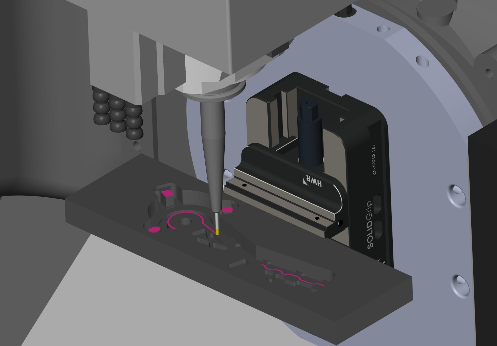

A wide range of strategies in hyperMILL® both simplify and enhance the programming experience. Alonso credits the hyperMILL® VIRTUAL Machining capabilities for enabling Novo Modo “to take off like a rocket, from the start.” “The machine was fully assembled on the floor and we were successfully programming and cutting chips in days, without any crashes. It was incredible,” he said. hyperMILL® VIRTUAL Machining software simulates, generates, and optimizes NC code and compares a digital twin of the machine for reliability and efficiency.
“When we have an inexperienced operator, the hyperMILL® VIRTUAL Machining capabilities actually allow the operator to fail at things such as establishing the right feeds and speeds, without the fear of collisions,” said Alonso. “It is a huge confidence booster, so we are able to give new employees a chance right away to be on the machine floor, programming and making parts.” hyperMILL® VIRTUAL Machining also saves significant time downstream. Alonso continues, “It has almost entirely eliminated programming issues that can arise at the machine, which is invaluable. hyperMILL® VIRTUAL Machining has also prevented us from getting too far down the wrong track, such as using incorrect tooling or workholding for a project. Without this capability, one could finish a 10-20 hour program only to discover a design flaw which requires substantial rework.”

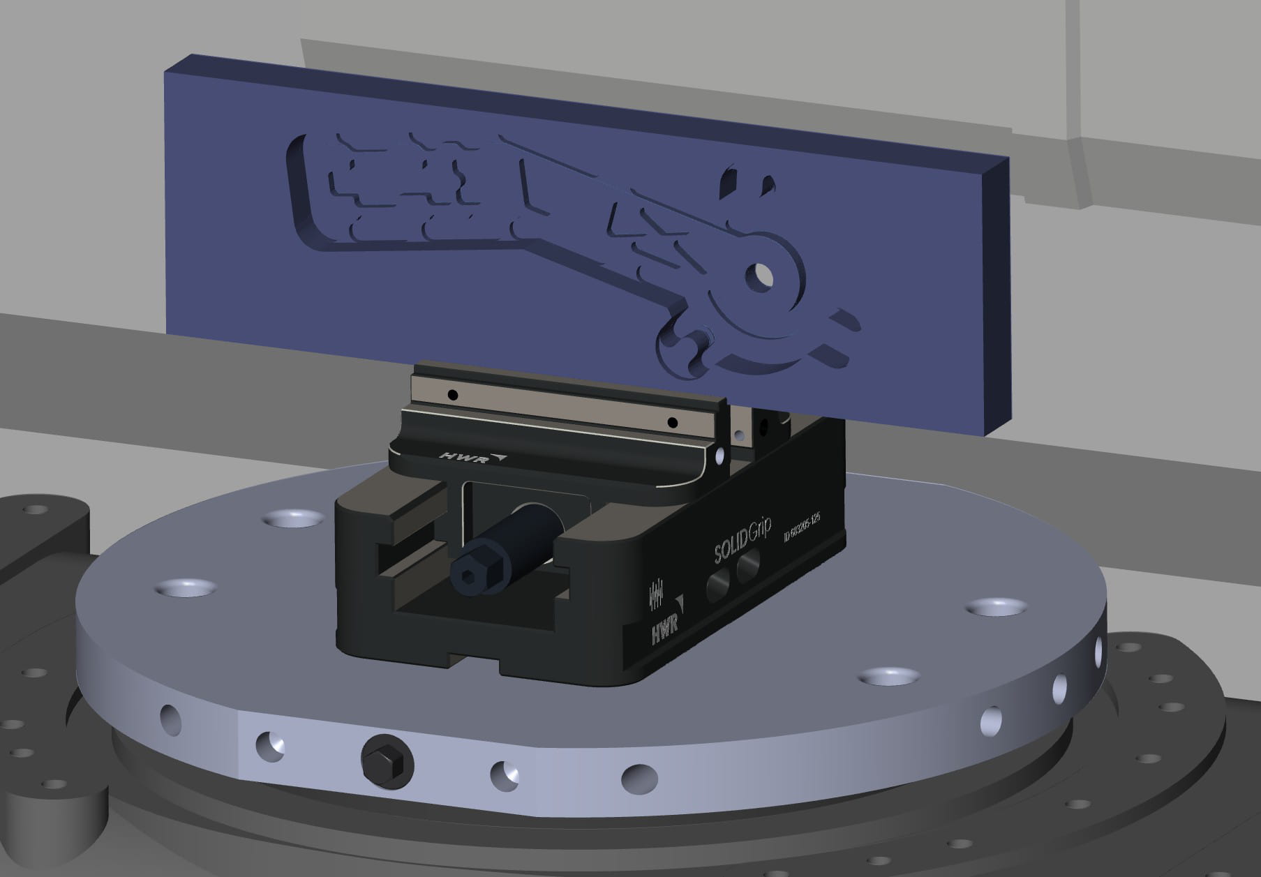

 – Satellite part utilizing, with toolpaths, a "Window Frame and Tab" technique to ensure all features are created in a single operation.<br />Held in an HWR self-centering 5-Axis Vice located on top of a Zero Point Fixture plate permanently mounted to the Hermle C250 Systems Trunnion.<br /><em>Image source: Novo Modo</em>
