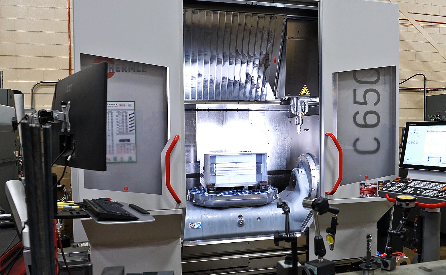

Furthermore, rather than wait for the new HERMLE C650 5-axis machine to arrive, Enmark began preparing early by installing hyperMILL® and conducting one month of R&D testing and part cataloging. This early implementation gave the programming team time to train, build model fixtures and risers, and develop toolpath strategies in advance. By the time the machine was installed, the team was already confident in using hyperMILL® and fully prepared to begin production.
“Our programmers had never used hyperMILL® before, but after just two days of in-house training, it came naturally to them,” says Michael Cox, Co-Plant Manager.
The structure and flexibility of hyperMILL® made it easy to create advanced toolpaths without requiring weeks of trial and error, making the transition to new CAM software incredibly smooth. The hyperMILL® system’s workflow aligned with the way Enmark approached part preparation and allowed the programmers to begin generating production-ready code almost immediately.

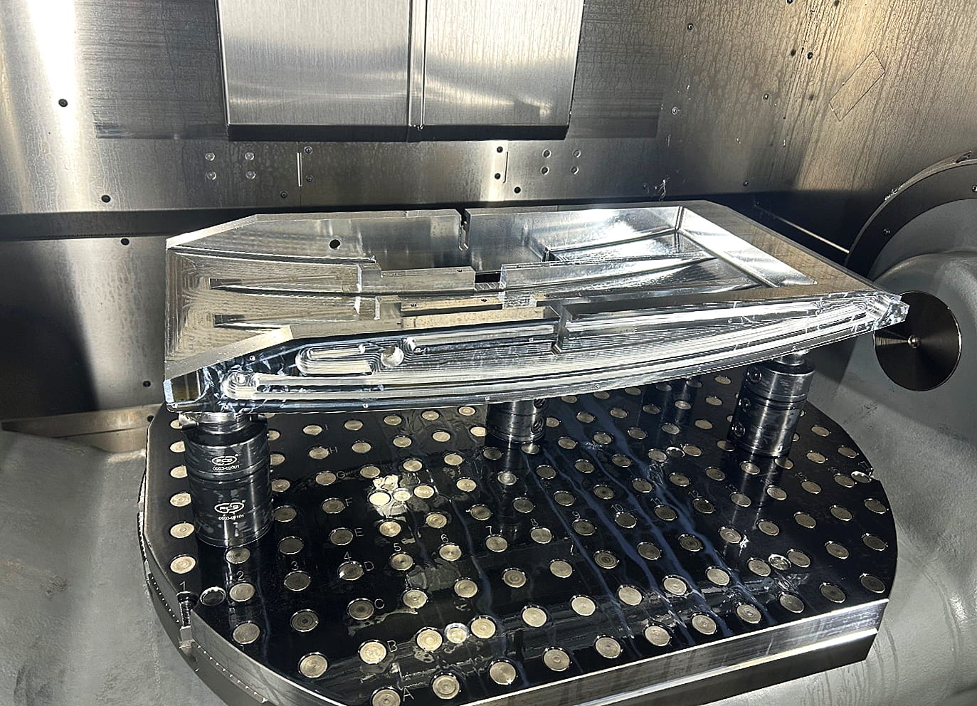

 – Complex parts are efficiently programmed with <em>hyper</em>MILL<sup>®</sup> to meet tight tolerances.<br /><em>Source: Enmark</em>
Complex parts are efficiently programmed with hyperMILL® to meet tight tolerances.
Source: Enmark

The impact has been particularly evident when using aftermarket machine components, such as a 90-degree head. hyperMILL®’s custom virtual machine environment has allowed the team to program complex angled features without writing manual NC code or worrying about compatibility with machine cycles. With confidence in the simulation’s accuracy, Enmark was able to run unattended shifts, knowing the NC code had been validated in advance.
“The Optimizer [enables] the table to rotate and tilt automatically. We have even drilled holes outside of the Y-axis limit—all within a single program,” says Michael. “If the VM says the program is good, our operator hits the green button and goes home. In the morning, the parts are done.”

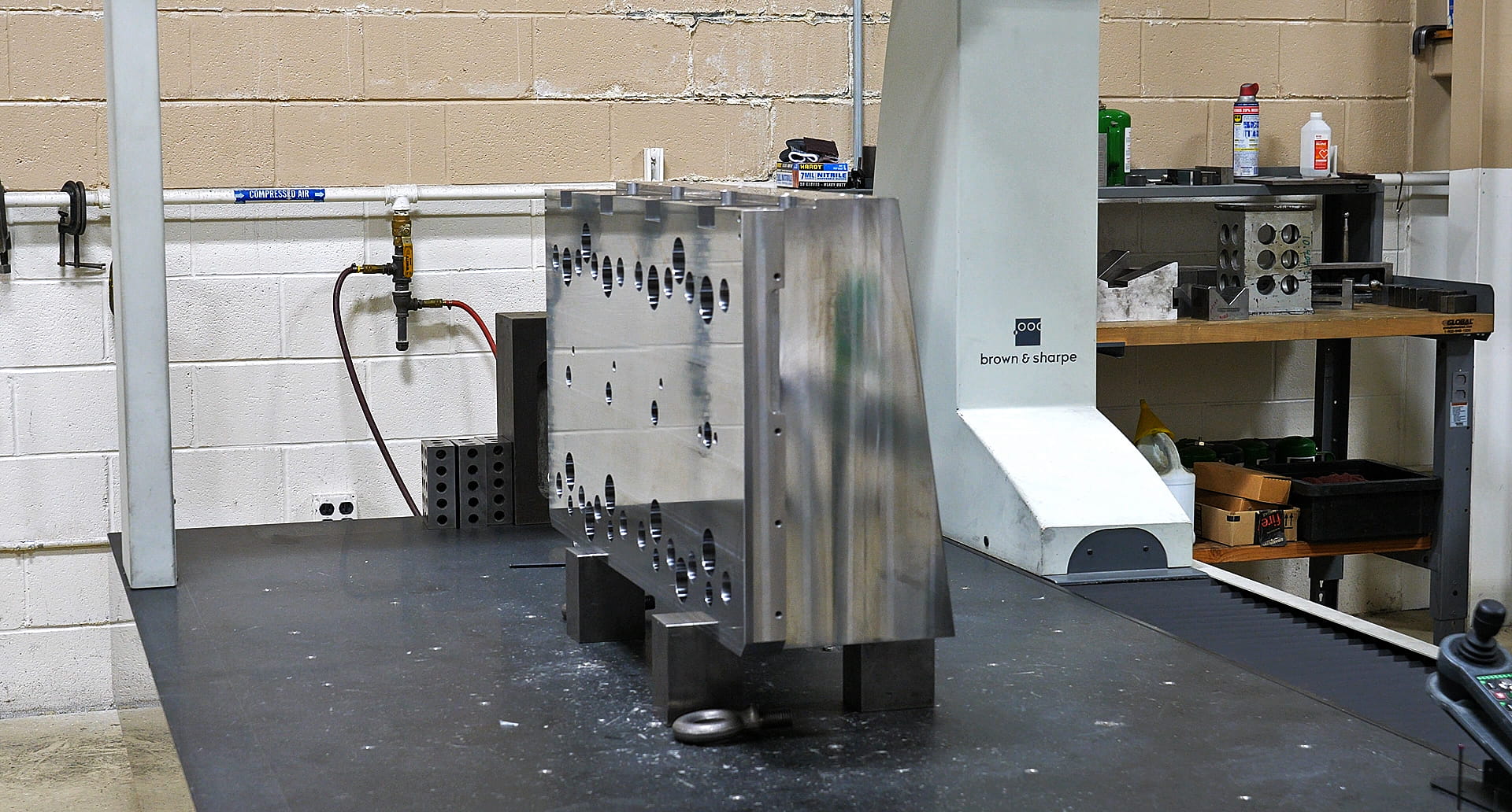

The need for this capability became clear at the onset on a very first large part job for the Hermle C650, which exceeded the machine’s travel limits. The job required drilling holes on the outside diameter and machining features beyond the Y-axis stroke. By running the program through Optimizer, hyperMILL® automatically calculates safe table rotations and tilts to reach these areas without over-travelling the machine. This eliminates the need for a complex programming approach or return paths, allowing Enmark to complete the entire job in a single program. The result was hours saved in programming time and a machining setup that handles oversized parts efficiently and safely.

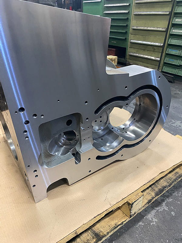

 – 5-axis trunnion head for a North American machine tool manufacturer. <em>hyper</em>MILL<sup>&reg;</sup> VIRTUAL Machining Optimizer allows the table to be rotated and tilted automatically for precise hole machining.<br /><em>Source: Enmark</em>
5-axis trunnion head for a North American machine tool manufacturer. hyperMILL® VIRTUAL Machining Optimizer allows the table to be rotated and tilted automatically for precise hole machining.

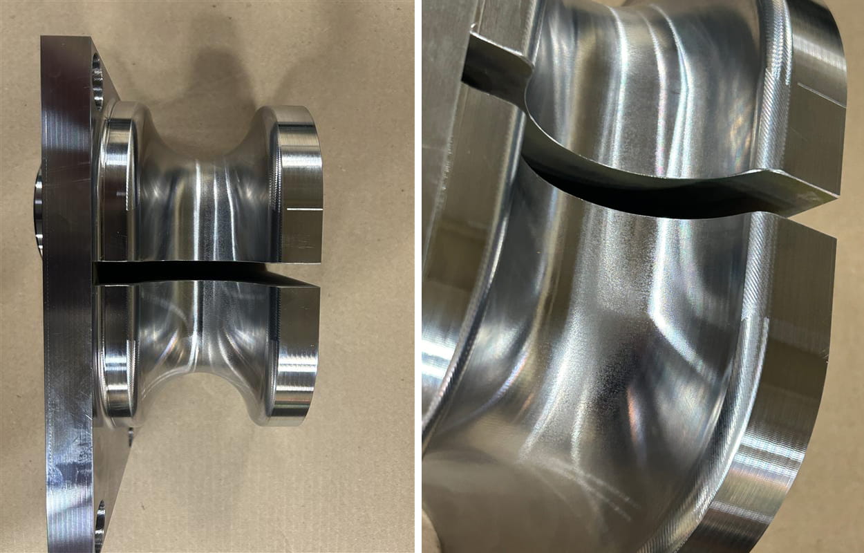

 – <em>hyper</em>MILL<sup>®</sup> 5-axis half pipe strategy used to efficiently program tube bending die.<br /><em>Source: Enmark</em>
hyperMILL® 5-axis half pipe strategy used to efficiently program tube bending die.

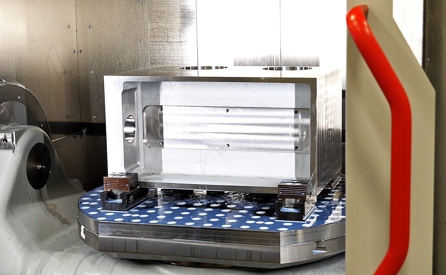

 – <em>hyper</em>MILL<sup>®</sup> has reduced programming time by at least 60%, reduced scrap and given Enmark great confidence at every stage.<br /><em>Source: Enmark</em>
hyperMILL® has reduced programming time by at least 60%, reduced scrap and given Enmark great confidence at every stage.

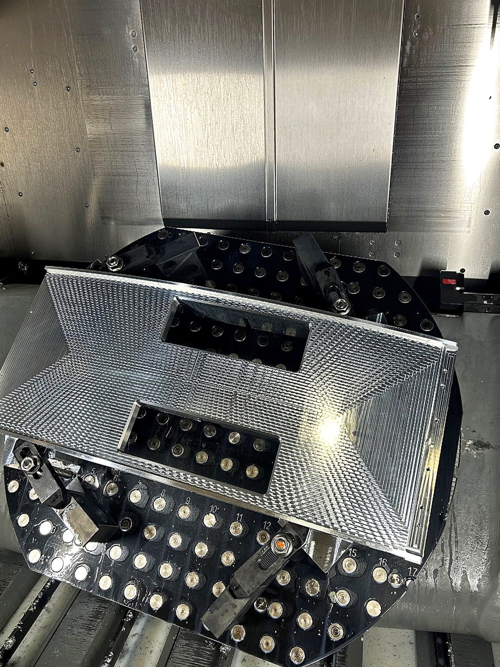

5-axis composite material guide
Source: Enmark
