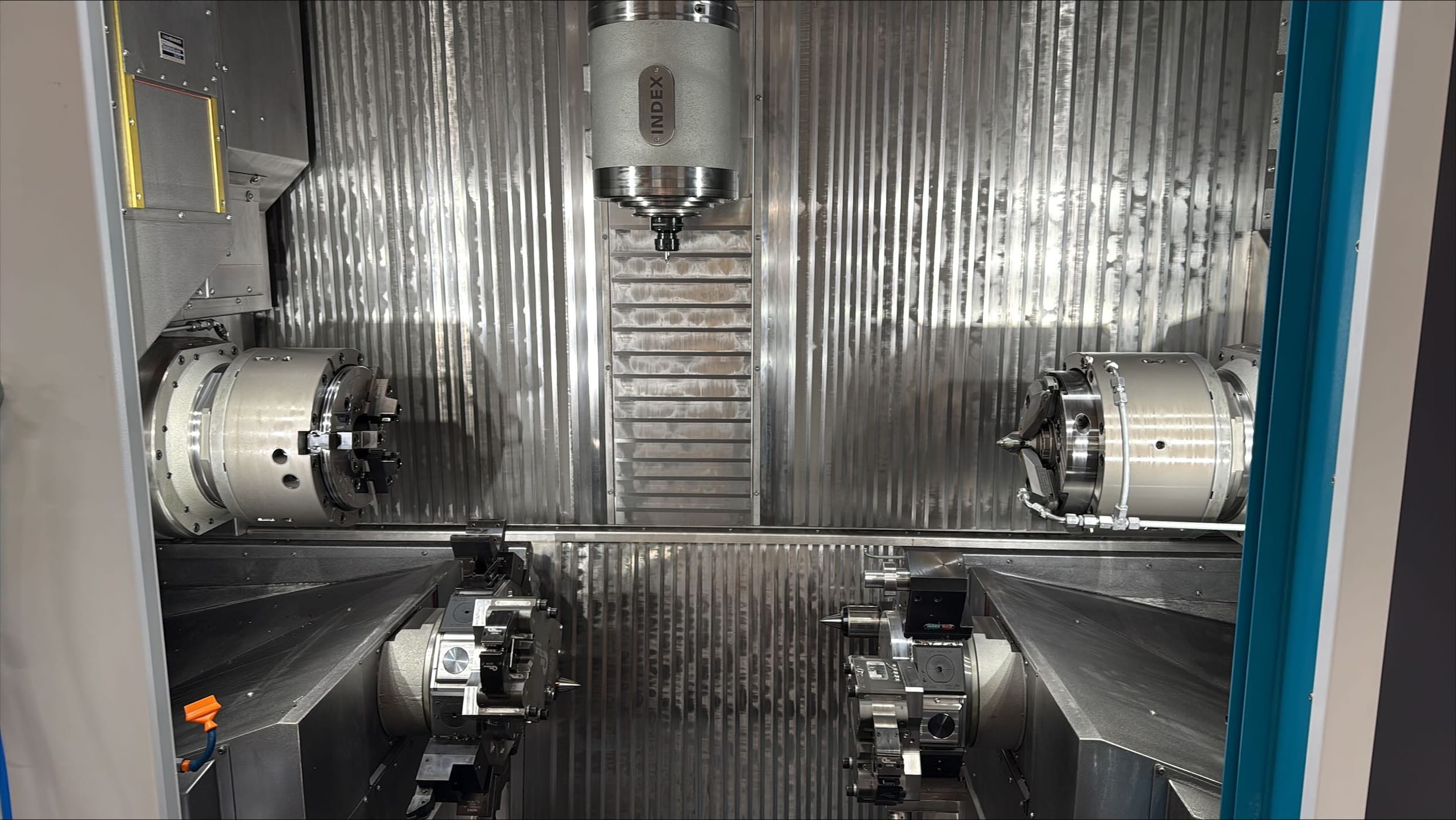

Multi-Channel Turning
Multi-Channel Turning describes the machining of workpieces on machine types with multiple tool carriers and working spindles, as well as peripheral machine components such as steady rests, tailstocks, loading and unloading systems, or integrated automation solutions. All units involved must work together as synchronously as possible in order to map complex machining processes efficiently and with high process reliability.
hyperMILL® allows you to conveniently coordinate all machining channels precisely—both automatically and through targeted manual control. This means that even highly complex machining sequences with parallel and sequential operating tools can be reliably controlled.
The result is optimally utilized machines, minimized downtime, and a highly productive manufacturing process—even for complex components and demanding multi-channel machine configurations.
